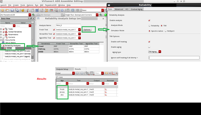

After an EM/IR run completes, the menu item: results > EM/IR Data > Report can generate non-selfheating-aware EM/IR text reports.
To get selfheating-aware EM/IR text reports, we open the viewer from EM/IR Data > Layout analysis...  let it load, and then type commands such as
print_em_report -net all_nets -type avg_sh -filename ./avg_sh.txt
at the Voltus-FI console.
Are there other ways create the selfheating-aware EM/IR text reports after a run? (Or a way to pass commands to an active VFI session from CIW, so a SKILL function can be used)
Here are things we have tried:
- An additional license is needed if we start a batch mode process. We have limited number of licenses.
- In Voltus-FI XL user guide, Table 4-1  Supported EMIR Control File Options listed that print_em_report=[...] can be used with emirutil in a control file. We tried adding
emirutil print_em_report=[net=all_nets type=avg_sh filename=avg_sh.txt]
to the prerun emir.conf, and to the viewer .conf file, but text reports were not created in both cases.

  • Saloni Chhabra
    Saloni Chhabra over 8 years ago in reply to hchan
    Thanks, it appears to be a bug in MMSIM where it is invoking emirreport before *.xml is available on the disk. Your MMSIM version is very old (more than 2 years), so can you please move to a newer version and check if that solves the issue?
    Going back to the older posts in this thread, I notice you were using Spectre171 at some point, so that will be a good version to try.
    Saloni

  • Saloni Chhabra
    Hi Henry,
    Thanks for sharing, I think I understand the problem. You have missed enabling Reliability Analyses from maestro view.
    When running the SHE flow, you should typically see 3 simulations running: fresh, stress and she. Correspondingly, the point numbers in maestro database are 1, 2, 3. Fresh simulation is optional, so the minimum simulations/points you'd get are 2. Out of these simulations, the last one is the SHE run where emirreport should be launched.
    In your log excerpts, I see all messages in point '1' e.g. Interactive.85/1, while the SHE simulation should have been Interactive.2 or .3. This gave me the clue that the setup isn't correct.
    Here's a snapshot of how reliability analysis should be enabled, and how the results will look like. Let me know if this helps.
  • hchan
    hchan over 8 years ago in reply to Saloni Chhabra
    HI Saloni,
    Thanks for the detailed information. I enabled TMI in the ADE explorer menu Simulation > Reliability > setup, but indeed didn't enable TMI under Reliability Analysis setup > options > Reliability. I did exactly what your screenshots showed, but the execution order of writing emirreport and then xml file did not change in the SHE run. I tried
    Fresh+Stress+SHE tests
    Fresh+SHE tests
    Fresh Test + stress file input.tmiage0 from prior run + SHE test
    Enable TMI self-heating only
    Enable TMI self-heating and aging
    All tests used Spectre 17.1 isr2, ICADV12.3 isr15, ended with xml file not found, because it was written after the vfi.log finished.
    I noticed that all my runs created the input.dtemp0.xml, not not input.tmiage0.xml file shown in your log.
    Henry
