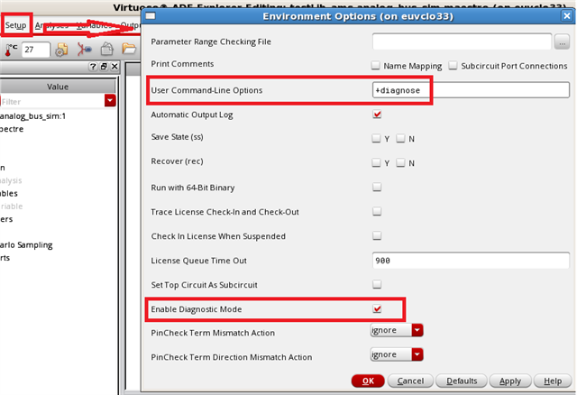

I am having a problem with running time in ADE L. I wrote a zero detector circuit in verilog A and added this to my schematic. However, I don't know why this caused the simulation is very very slow. It ran OK before adding this.
The circuit is somewhat complex and I am afraid of Cadence Online Support because it is usually slow to get response and not solve the problem.
I would like to attach the output log with some warning about delay buffer and the zero dectector circuit in verilog A. Hope someone can tell me what is wrong here.
zero detector circuit in verilog A:

    I couldn't find "diagnose" switch (a button on the Setup->Environment form) as you said. Where is the Setup button?
    May I report custormer support to other place not through my university in Korea?
    I am disappointed with support here. I created some cases but support is too long and not effective.
  • Saloni Chhabra
    Saloni Chhabra over 8 years ago in reply to BaaB
    The setup button is in ADE. I don't know which IC version you are using, so you can add the user command-line option '+diagnose' yourself if you don't see the option to Enable Diagnostic Mode. But this option may not work with MMSIM121 as this version is very very old, but you can give it a try.
  • Saloni Chhabra
