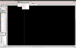

I was working with ModGen two weeks ago and it was fine. Now, I wanted to go back and do some modifications but I cannot open the menu! I used the following path:
Windows -> Assistant -> Constraint manager
But now, I do not have such menu which seems quite weird. Here is the screenshot:
Does anyone know what is the problem and how can I solve it? Briefly, I want to see the window on the right side of the Cadence to be able to edit ModGens and create new ones. Cadence Version is IC6.1.6-64b.500.6. Thanks.
    Andrew Beckett over 8 years ago +1
    The constraint manager is only in Virtuoso Layout Suite XL (or GXL). You're using VLS L from the picture, and so the assistant won't show up. ModGens themselves require GXL licensing and so must be used…
    The constraint manager is only in Virtuoso Layout Suite XL (or GXL). You're using VLS L from the picture, and so the assistant won't show up. ModGens themselves require GXL licensing and so must be used in the XL or GXL environment.

    Thank you Andrew. Using the Layout GXL, the problem is solved and I am able to work with ModGen. Thanks again!
