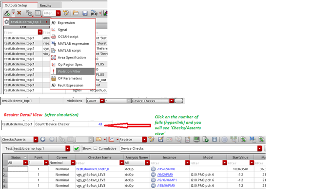

    Yes, you can add an output type called 'Violation Filter' and set it to count all device checks. This can be done in both Assembler and Explorer.  After the simulation has finished, you will get the number of violations (if any).
    I want to add a snapshot here describing the steps, but I cannot find a way to insert the image. I'll come back to you.
    Saloni
  • Saloni Chhabra
    Saloni Chhabra over 8 years ago in reply to Saloni Chhabra
    Here it is (I realized I wasn't logged in so wasn't getting the option of uploading a file):

    Andrew Beckett over 8 years ago in reply to PatrikOsgnach
    Hi Patrik,
    Why do you need a SKILL function to do this? The violation filters allow you to construct a query (actually an SQL query) to refine what you want to look for (so to construct more complex queries) and you can then count the results, find the maximum of a particular value, or the average of some value - there's quite a lot of flexibility. I'm not sure why a SKILL function would be beneficial here.
    In the past using the older way of storing the violation data (which was in PSF format), I did write a function which counted the number of violations. However, since we're now turning off writing the data to PSF (for a while it wrote both PSF and to the SQL database), that's not going to work going forward. It also predated the ability to directly add violation filter outputs in ADE XL and Explorer/Assembler.
