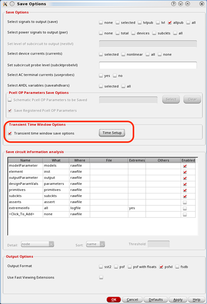

    If using a recent IC617/SPECTRE171 version combination (might be OK with SPECTRE161 too), you now have a choice of defining windows to save particular signals - on the Outputs->Save All form in ADE:

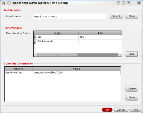

    Then you can check this checkbox and click the Time Setup and choose which signals to save for which time windows:
