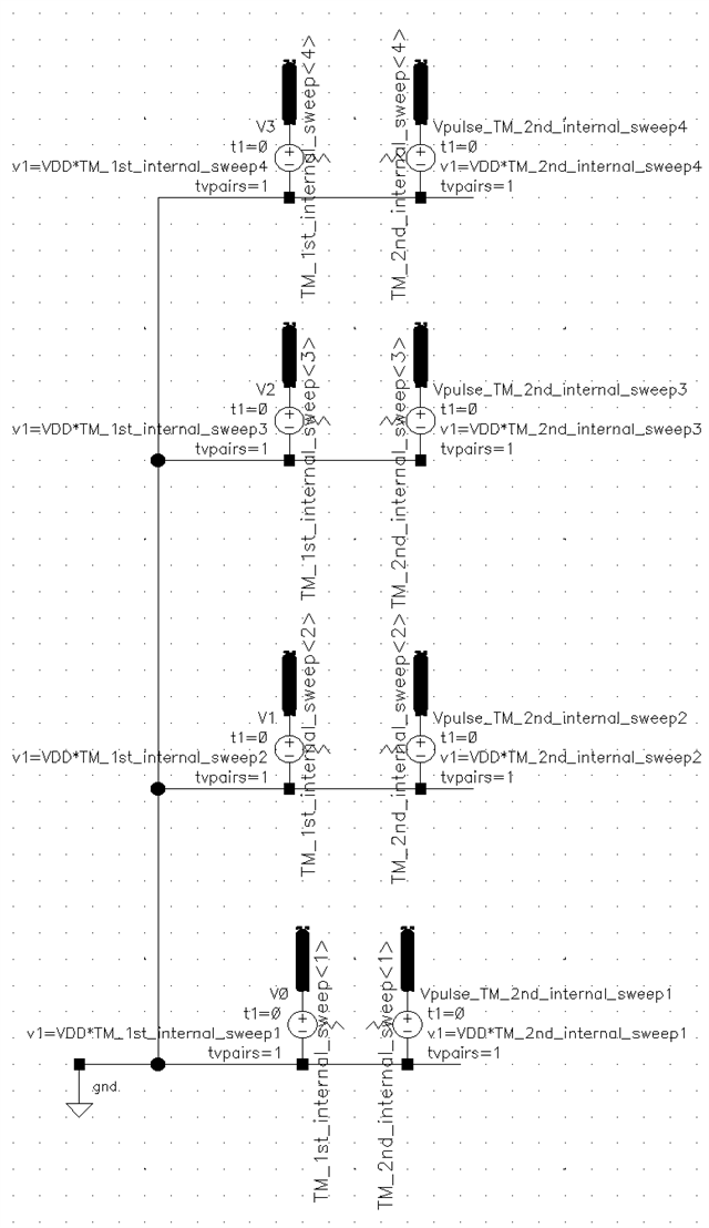

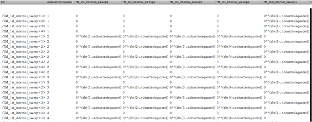

I am running virtuoso 6.1.7 500.17. In my TB, I created a maestro view (my first one) and ran a simulation with the following corners for one test:
Corners TM_1st_internal_sweep TM_2nd_internal_sweep
TM_2nd_internal_sweep_var1 0 0**(abs(1-undeuxtroisquatre))
TM_2nd_internal_sweep_var1 0 0**(abs(2-undeuxtroisquatre))
TM_2nd_internal_sweep_var1 0 0**(abs(3-undeuxtroisquatre))
TM_2nd_internal_sweep_var1 0 0**(abs(4-undeuxtroisquatre))
TM_1st_internal_sweep_var1 0**(abs(1-undeuxtroisquatre)) 0
TM_1st_internal_sweep_var2 0**(abs(2-undeuxtroisquatre)) 0
TM_1st_internal_sweep_var3 0**(abs(3-undeuxtroisquatre)) 0
TM_1st_internal_sweep_var4 0**(abs(4-undeuxtroisquatre)) 0
undeuxtroisquatre 1 2 3 4 1 2 3 4

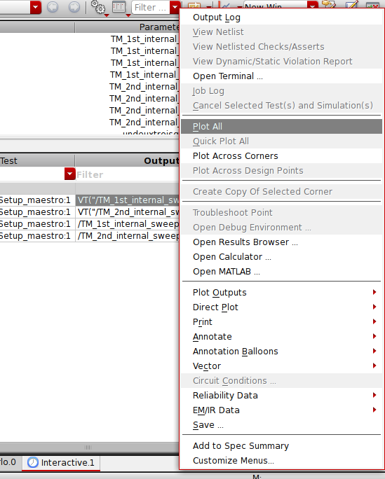

However, the RMB over the output tab and neither plot all neither Quick plot all returns the plots of the corner TM_1st_internal_sweep, I only get the plots of the last executed TM_2nd_internal_sweep.
I know that it could be workaround by avoiding undeuxtroisquatre variable and expending all corners, but it is more compact like this and multichannels circuits are easier to design and verify with this kind of setup while keeping a readable corner setup window.

    Hi Andrew,
    Here are the screen shots of the setup I am basically talking about. Hope it is clear enough ^^
    Kind regards,
    Gabriel

    I just simulate this basic example it works actually.
    I have to investigate why it doesn't work in a more complex setup.
    Sorry for the countertime.
  • Gabriel Puech
    Gabriel Puech over 8 years ago in reply to Gabriel Puech
    Ok, so if I ask cadence to plot All the signals for this exemple pane it doesn't plot the corner TM_1st_internal_sweep_1 (with undeuxtroisquatre=1).
    However, it plots all others expanded corners TM_1st_internal_sweep_X  (with X=undeuxtroisquatre=2 3 4) and all TM_2nd_internal_sweep_X (with X=undeuxtroisquatre=1 2 3 4).
