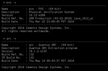

    It is odd that trying to run PVS LVS gives an error related to QRC. Can you tell me what the below commands return in a terminal:
    pvs -v
    qrc -v
    Saloni
  • dontpanic
    dontpanic over 7 years ago in reply to Saloni Chhabra
    Thanks for your reply, Saloni. Please find below the output of both commands:

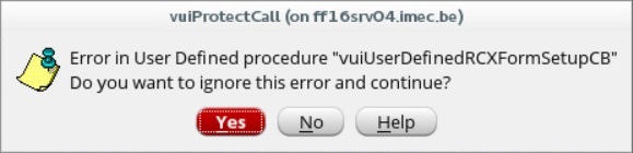

    I am trying to follow the PVS-QRC flow as described in "Setting PVS to Quantus QRC av_extracted view Flow with tsmc16 LVS package". In particular, I get the error at Step 5 ("Running PVS LVS", p. 20).
    Moreover, I get a different error at Step 6 ("Running Quantus QRC", p. 22), as shown below:
    ...and in the CIW I get the following message:
    QRC Run: Loading Technology Data. Standby...
    *Error* eval: unbound variable - preRCXQueryUI
    Could you please give me a further hand on these?

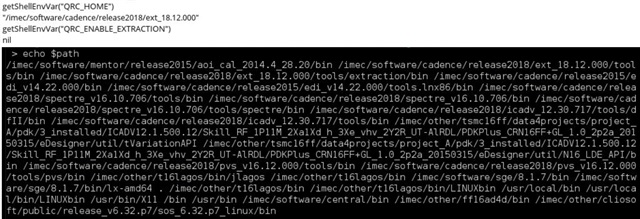

    Can you tell me what the below commands return in CIW:
    getShellEnvVar("QRC_HOME")
    getShellEnvVar("QRC_ENABLE_EXTRACTION")
    Also, in your terminal, what does 'echo $path' return?
  • dontpanic
    Please see below the requested outputs:

  • Saloni Chhabra
    Saloni Chhabra over 7 years ago in reply to Saloni Chhabra
    Things look ok. Going back to the error you mentioned you get when the pop-up asks 'Do you want to ignore this error and continue?' : what happens when you click on Yes? Does any form come up?
  • dontpanic
    The QRC form does come up and I'm able to perform extractions; I however wonder if the error is having some impact in the extraction results I get.

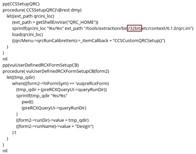

    Would it be possible for you to share the outputs of the following 2 cmds?
    pp(CCSSetupQRC)
    pp(vuiUserDefinedRCXFormSetupCB)
    Best regards
    Quek
  • dontpanic
    dontpanic over 7 years ago in reply to Quek
    Thanks for your reply Quek; please find below the output of the commands; indeed, it seems the 32bit directory is hardcoded in my setup!
    ...is it maybe possible to correct that path to the right (existing) directory (64bit)?
  • Quek
    Quek over 7 years ago in reply to dontpanic
    Hi Jorge
    Would you please try the following and let us know if it helps?
    a. Open a new text file named "CCSSetUpQRC_mod.il"
    b. Add the following lines in it:
    procedure( CCSSetupQRC(@rest dmy)
       let( (ext_path qrcini_loc verInfo ver)
          ext_path=getShellEnvVar("QRC_HOME")
          unless( ext_path error("QRC_HOME shell variable cannot be found"))
          verInfo=getVersion('subVer)
          pcreMatchp("IC(\\S+)-" verInfo)
          ver=pcreSubstitute("\\1")||"6.1.0"
          qrcini_loc=sprintf(nil "%s/tools/extraction/bin/64bit/etc/context/%s/64bit/qrc.ini" ext_path ver)
          load(qrcini_loc)
          qrcMenu~>qrcRunCalibreItem~>_itemCallback="CCSCustomQRCSetup()"
       ) ;let
    ) ;procedure
    procedure( vuiUserDefinedRCXFormSetupCB(form)
       prog( (runDir)
          when( form~>hiFormSym=='vuipreRcxForm
             form~>runName~>value="Design"
             if( hiIsForm('preRCXQueryUI) then
                runDir=sprintf(nil "%s/%s" pwd() preRCXQueryUI~>queryRunDir)
             else
                runDir=sprintf(nil "%s/%s" pwd() form~>runName~>value)
             ) ;if
             form~>runDir~>value=runDir
          ) ;when
          return(t)
       ) ;prog
    ) ;procedure
    c. Load it in CIW using:
    load "./CCSSetUpQRC_mod.il"
    I think it should resolve the problems. : )
    Best regards
    Quek
  • dontpanic
    Thanks again for your reply, Quek; I still get the same error:
    QRC: *Error* load: can't access file "[...]/ext_18.12.000/tools/extraction/bin/64bit/etc/context/ADV12.3/qrc.ini"
    but this time because the [...]/ADC12.3/[...] folder doesn't exist in my installation! Instead, a folder "6.1.7" exists in that location. Maybe the function redefinition needs a little more changes?
