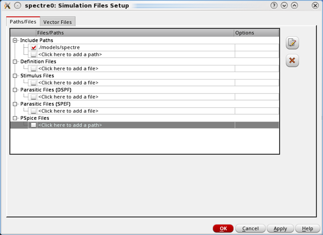

Hi
I've been trying to implement an infineon power switch model (SPA12N50C3_L1) in virtuoso. I used the NMOS4 from the analoglib for the purpose and I added a model file that i got from infineons website. I also added the command line 'simulator lang=spice ' at the beginning of the code. However it still keeps throwing up errors. I came across another cadence thread where someone had said that this command line would only convert Berkeley spice and not pspice code. I am attaching the unedited code bit below

    If you look on Setup->Simulation Files in ADE you can enter the path to PSpice Files directly at the bottom of the form. This uses the spectre construct pspice_include which then knows that the file is in PSPICE rather than Berkeley SPICE syntax. Support for PSPICE files appeared in (I think) MMSIM13.1 - so you need to be using a version of spectre from at least then. I can't remember exactly when the UI appeared in ADE.

    Hello Andrew
    Thank you so much for the response. Your method is working but I've hit another roadblock. I usually use the nmos4 or the nmos and then link it to the model file. But I keep getting the error '' ERROR (SFE-46): "input.scs" 385: `M0': An instance of `SPA12N50C3_L1' can have at most 3 terminals (but has 4).'' . Is there any way around this ? I can see that the nmos has only 3 nodes shown but it also has an additional bulk node connected to ground.

    Hi Thomas,
    This is because the model you were using is a three terminal subckt, and the nmos4 (the 4 is the clue) is a 4 terminal transistor. To fix this you could take your nmos4 and remove the bulk pin from the symbol (and the spectre view) and then in the CDF (Tools->CDF->Edit, pick "Base" as the CDF Level and then go to Simulation Information and find the spectre simulation information, and remove the B references in the termOrder and termMapping).
    The 3-terminal transistor nmos doesn't help much because the stopping view (spectre view) has a terminal for B which finds the fourth terminal via a property - so you'd have to do pretty much the same edits to that too.

    Thanks a lot for the response. I will try the method you suggested. I did manage a workaround in the mean time, I added an extra pin (functionally useless) the to the model file that i downloaded. Its working fine now.
