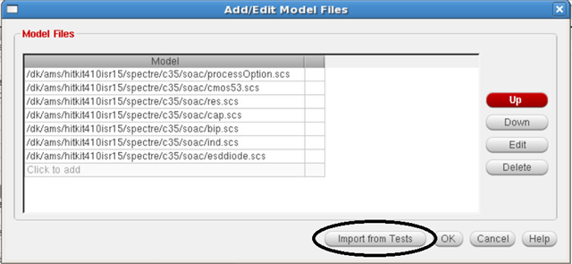

    What this is saying is that you don't have all the model files included when you're simulating. I'm not sure if you've set up corners in ADE XL - if you have, is it including all the right files? Bear in mind you need to include all the files in the corners set up which are in the Setup->Model Libraries in the test itself; anything that is under Setup->Simulation Files in the test don't get included in the corner setup - they will be included in the netlist anyway.
    Taking a look at what the include statements in the netlist are between the situation that works and that which doesn't ought to give some pointers as to what is going wrong.

    When i set up the corners in ADE XL i add the model files by clicking the "Import from Tests" button and ok (picture). Thats basically all i do to reference any models. This should be adequate right? I am trying to follow a small guide which demonstrates this, i have not much prior experience with it.

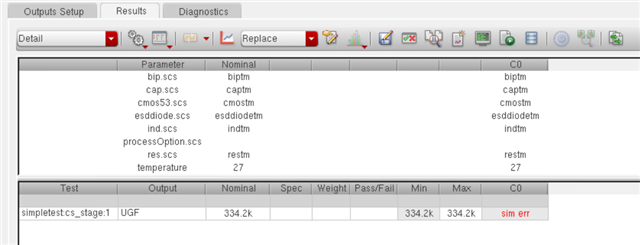

    I would like to add that it successfully run the 'Nominal' case without errors, and even though i specify the corner test to run the same corner it still fails at that. see picture here: corner results page
    I find that rather strange.
    Andrew Beckett over 7 years ago in reply to SteffenK
    It’s not necessarily strange if there’s a difference between the model setup in the test (which is what the “Nominal” corner uses) and the model setup in the corners. As I said, I’m sure it will be obvious once you look at what is being included in the netlist in good and bad cases.

    You were right. There is no includes at all when i look at the netlist created by ADE XL. When i look into the netlist that ADE L creates, they are all included as they should be. Do you have any idea why/how this happens? As i showed earlier, i did add the files in the corner setup page
    That seems rather odd, because the messages in your original post implies that at least some of the model files are being included.

    SteffenK over 7 years ago in reply to Andrew Beckett
    I was not aware of this method of viewing the netlists, so i must of had opened the wrong ones. So the includes WAS referenced in the netlist, but it turns out a certain "ProcessOption.scs" has to be enabled in the corner setup too for it to work. I guess this is something PDK specific. Anyway, i was not aware of this until i looked at the netlists differences between the two cases. But this solved the problem.
    Thanks a lot for your time and help!
