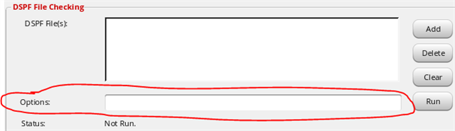

    If that's the case, should I use option -ckt top_level in the highlighted field of the EMIR setup (in the attached pic)?

    Yes, you can use -ckt argument in the field you highlighted, and that will tell spfchecker which subckt to check. However, that still does not mean that EMIR analysis will work.

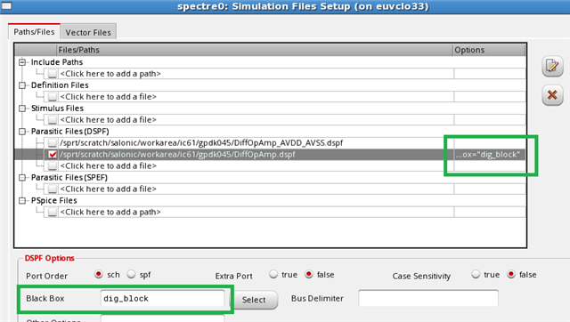

    You also need to add black_box="dig_top" argument in dspf_include statement in Spectre netlist. Are you including the DSPF through Simulation Files in ADE? If yes, then you can provide the black-box name as shown in snapshot below (make sure you hit apply so it becomes visible under Options column). You can also check dspf_include statement in input.scs to make sure that you've got argument there as: dspf_include "/path/to/top.dspf"   black_box="dig_top"

    The error message says that the number of ports found in Spectre netlist for 'dig_block' is much smaller than the ports found in the empty subckt definition in DSPF. This can happen when you run black-box extraction. To get past the error, you can try setting option 'extra_port=true'. This is available under DSPF Options in Simulation Files setup (just a row above where you specified Black Box name). Any extra ports in DSPF will be ignored and will not be driven by the testbench/design.
