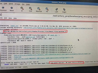

    Hi Andrew, thanks for your suggestions. I followed your approach 3 by "setenv SPECTRE_DEFAULTS /net/artery_proj/bowhao/Process_Files/Model_Files/umc55nm_LP". and it works (log file displayed content of  "SPECTRE_DEFAULTS").
    i specified model file as "sim_model.lib.scs" (full path is: /net/artery_proj/bowhao/Process_Files/Model_Files/umc55nm_LP/sim_model.lib.scs), and run simulation. while simulator failed to find it. did i missed anything, or did I set SPECTRE_DEFAULTS correctly?
    Andrew Beckett over 7 years ago in reply to Pic Hao
    You omitted the -I before the /net/...
    You should have done:
    setenv SPECTRE_DEFAULTS -I/net/artery_proj/bowhao/Process_Files/Model_Files/umc55nm_LP
    The -I is necessary to specify the include path.
