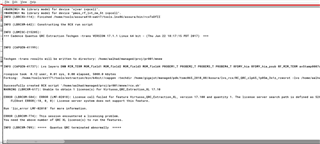

I'm trying to run parasitic extraction on Assura QRC, and the run is failing. The log file says that it couldn't get the library models for the NMOS, PMOS. Something like this:

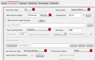

My setup is as follows:
Can someone tell me what's going wrong? Andrew Beckett  Tawna ?

    You had encountered a licensing error as indicated in the log file. Quantus XL license is required for the extraction but the license is not available.
