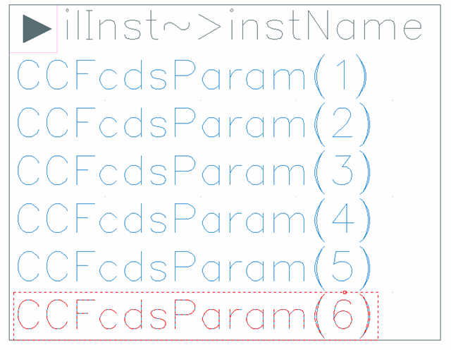

    I agree I didn't explain myself very well. Here's some additional background:
    To prevent the ugly mess that occurs when annotations are turned on I made my own symbols for all the TSMC transistors - they don't have any cdsParams or cdsTerms and I made my own labels to show W/L etc. Those symbols exist with the cells of the official symbols in the TSMC library and I called them symbolx.
    I have a design I'm developing in a project library that uses those TSMC symbols.
    I used your CCFcdsParam procedure to make a cell called view_params that can show the cdsParams of another cell and that cell exists in yet a different (non-project) library. view_params takes a parameter (instName) which is the name of the instance I want to display the parameters for - see attached picture.
    So I make my design in the project library with TSMC transistors using only symbolx devices and I place a few instances of view_params in open spaces so I can see the annotations for the devices they reference. I then run a sim. I can turn on annotations etc. and obviously the transistors aren't drowned in annotations, but the the view_param instances I placed don't show any annotations either :-(. Let's say I have a view_params cell referencing a transistor named mn1 and a view_params instance pointing to it - both aren't displaying any cdsParams. Having run a sim, if I now select mn1 and change it's instance from symbolx to symbol then right away I see that symbol change and be covered with tons of annotations. If I now redraw/refresh the screen all the annotations on the view_params cell referencing mn1 also show those annotations. If I now go back to mn1 and change it back to symbolx then mn1's annotations disappear but the view_params cell referencing mn1 continues to display mn1's annotations i.e. the view_params cell needed the cell it's referencing to be kicked in the pants once before it worked. I need to do this individually for each transistor being referenced by a view_params instance...
    Hmm - I'm only seeing a generic box with a question mark inside it after attaching a screenshot of the view_params block. Hopefully you can see it.

    Andrew Beckett over 7 years ago in reply to CADcasualty
    OK, there were two issues:
    1. The "new" (it's newish now) annotation flow checks to see if there are actually cdsParam() labels on the instance, and if not, it returns an empty string. The simplest way around this is to temporarily switch back to the old annotation flow though to workaround this. Not entirely sure why it does this check - it may be so that all the data can be cached in one hit, but not sure it has to be that way.
    2. For cdsTerm labels, it turns out that the cdsTerm macro quotes the argument, so that means that you can use cdsTerm("D") but not cdsTerm(termName) because it looks for a terminal literally called termName (it's because strictly speaking you can just to cdsTerm(D) without the quotes). So I had to use the expansion of the cdsTerm macro, which is a private function - you can find this out yourself easily enough as you can see how macros expand, but it could change in future.
    Here's the updated code. I'd suggest contacting customer support and asking for a public way of doing this lookup on another component approach, as the way I'm doing it is a bit of a hack...
