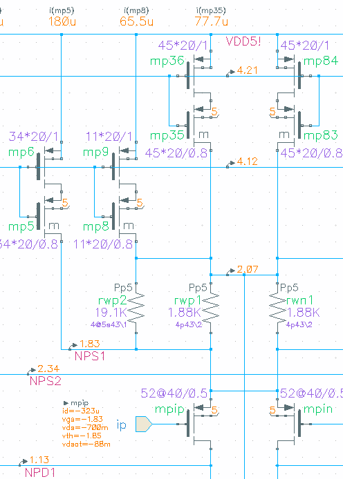

    Sorry for the late reply - I've been away for a few days.
    I can't thank you enough for your help getting all of this up and running!! I've been able to take your suggestions and make an unobtrusive net voltage monitor, a bias leg monitor, and a cell that displays the cdsParams of another instance. I've attached a screenshot of part of one of my schematics showing those cells in action.
    The only thing I still wish for is being able to directly access the various simulation or model aspects without having to go through the awkwardly indirect route of cdsParam() i.e. it'd be great to directly access e.g. the gm of mp42 etc.
    Andrew Beckett over 7 years ago in reply to CADcasualty
    Glad you got it all working - that looks good!
    If you don't want to go via the cdsParam() approach, you could simply use OP(strcat(geGetInstHier() "/" instName) "gm") - the main downside of that is that you then won't get the ability to change what is annotated via the menus in ADE, or using the annotation setup form in the schematic - up to you.
