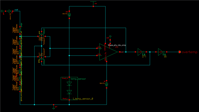

    I'm simulating a temperature monitoring schematic. In above simulation curves, the left curve is hysteresis high of overtempt (overtempt is output signal), and the right curve is hysteresis low of overtempt.
    The schematic diagram is below:
    From the schematic, you can see that, a resistors divided reference voltage compares with a negative temperature coefficient voltage, then following after two invertors to get overtempt.
    You said my measurement has only discrete levels. I think it's because of the invertors and comparator.
    But why the points on right side curve distribute like a two peak?
    Or for the sampling method, I selected 'random', do you think 'low-discrepancy sequence' will be better?
    Nelson.
    Thanks!

    I do DC simulation in Monte Carlo sample, and sweep temperature from -40 to 175C, and from 175C to -40C.
    The node voltage of diode in schematic changes following the temperature value.
    If the temperature is increasing from -40 to 175C, and it gets to high enough like 164C, the comparator can detect that the voltage of diode is higher than resistor divided voltage, then the comparator will output high, this temperature (164 C) is "hysteresis high of overtemp";
    If the temperature is decreasing from 175 to -40C, and the temp is lower than like 138C, the comparator can detect that the voltage of diode is lower than resistor divided voltage, then the comparator will output low, this temperature (138C) is "hysteresis low of overtemp".
    The X axis in above curve means "temperature". And you can think that "hysteresis high or low" is a threshold , temp is higher than the threshold, the output of this schematic is high, else it low.
    My doubt now is that the threshold should be very normal distribution, just like threshold voltage of a NMOS or PMOS which does not have just two or three discrete value in Monte Carlo simulation.  But the values in above right curve are discrete 138C and 145C, and are not dispersive from 138C to 145C.
    Nelson.

    What was your step size for the temperature in the dc sweep?
  • syncteck
    syncteck over 7 years ago in reply to Andrew Beckett
    Hi Andrew,
    My simulation step size is 3, and sweep from from 0 to 230C.
    Nelson
    Andrew Beckett over 7 years ago in reply to syncteck
    Hi Nelson,
    Perhaps the variation is small enough that it only covers a few degrees, and so a step size of 3 is far too large. Perhaps you could sweep in 0.1 degree steps and sweep from (say) 120℃ to 180℃? (just to cut down simulating over an unnecessarily wide range) to see if that improves things. It's hardly surprising that you've only got discrete peaks at 3° intervals if you've only got a step size of 3!

    You reminded me that I ignored to check the step size in simulator and discrete step in curves! Thank you so much!
    I am simulating with much smaller step size,  and I think it will be work. Thanks.
