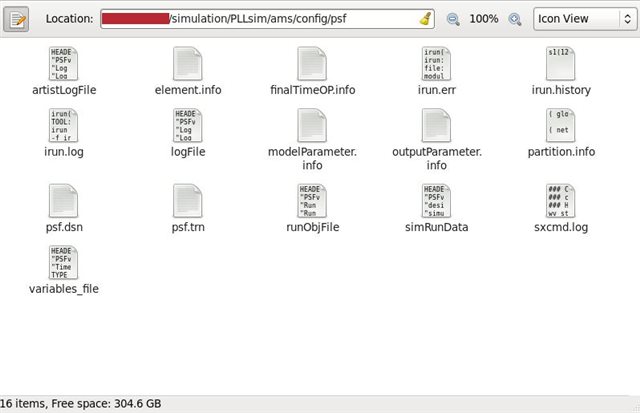

I am using AMS to do simulations( virtuoso 6.1.7-64b) , however, I'm used to adopting Waveview as waveform viewer.
Because Waveview doesn't support the psf format of spectre, I need to change the output format to "psfbin".
And I follow the flow:
1. Setting "config" view.
2. Enter envSetVal("spectre.outputs" "simOutputFormat" 'string "psfbin") to CIW.
3. Launch ADE L, and finish the setting of library, connect rules, APS.
4. Select OSS-based netlister with irun, and Create netlist
5. Press "Simulation and Run" of ADE
However, there seems no pdfbin file in the output folder.
Is there anything wrong in my settings?
Thank you.
    That won’t work. You’re setting the output format for spectre, not AMS.
    The way to do it for AMS is under Outputs->Save All. I suggest you pick “fsdb” as the output format if using WaveView (note, we don’t offer “psfbin” as a supported output format for AMS on this form). This however would only contain the analog signals - you’d have to use sst2+fsdb for digital and analog output signals - and I’m not sure whether WaveView supports sst2 (presumably not, since that was the default output format for AMS).
    In essence, this is an unsupported flow, so inevitably there are some limitations.
