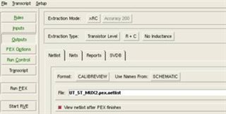

    I tried to perform a monte carlo (MC) simulation on a custom made standard cell with its extracted RC parasitics (see below settings) and a cell imported from above netlist. According to the documentation, the extraction mode of the .cir netlist is similar to following settings. With these settings I created a Calibre view for the custom cell.
    In the simulation environment, I set the starting view to be "Calibre" and the stope view to be "Spectre", so that both cells are available with their parasitics. And by that I expect a fair comparison between two cells.
    With process-mismatch variations enabled, I only see the variations in the waveform for my custom cell and not the cell in cir netlist. I also see that “mf” flag of the transistors in .cir netlist is set to 1. For some reason, the waveforms of .cir cell for all the iterations look superimposed without any variations (even for low VDDs). Moreover I selected all the top level schematic blocks (of both cells) to be included for MC. What could possibly go wrong here ?
