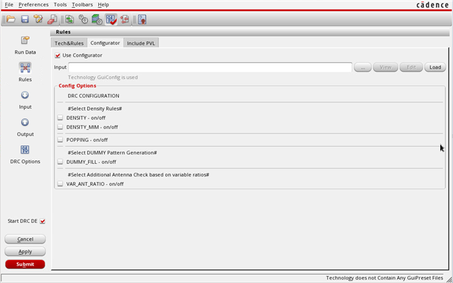

Hi all, Is there any bindkey to set bindkey to activate PVS-DRC/LVS windows ?

    i expect the window is pop up when you choose PVS/ DRC-RUN, like

    With the goal of teaching a man how to fish as well as telling you the answer, if you do (in the CIW) Options->Log Filter and turn on "\a Accelerated input..." and perform PVS->Run DRC or PVS->Run LVS from the layout window, you'll see the commands:
    _pvsOpenIPVSrunForm( 'drc ?timeout 30 )
    _pvsOpenIPVSrunForm( 'lvs ?timeout 30 )
    You can create bindkeys for the layout editor with these as the commands.
