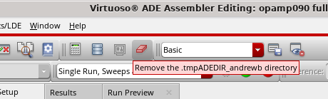

    It's automated, so we can't really do it selectively. Having users able to unlock old threads would rather defeat the reasons above. Anyway, as moderator I unlocked the thread and joined your post to it. Note that in IC23.1 there's now an icon in a toolbar to clean up the tmp dir:
