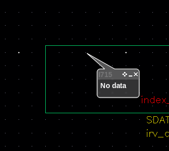

ychandr3
ychandr3 over 7 years ago
Has anyone seen this before? How to get rid of this?
Thanks in advance!

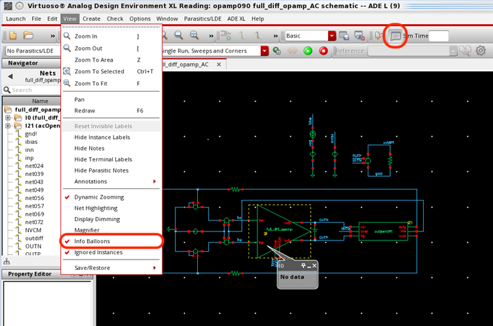

    Andrew Beckett over 7 years ago +1
    The first step would be to post this kind of question in the right place. The Feedback, Suggestions, and Questions forum is for issues related to the forums themselves rather than for technical questions…
    The first step would be to post this kind of question in the right place. The Feedback, Suggestions, and Questions forum is for issues related to the forums themselves rather than for technical questions.
    This is because you have annotation info balloons turned on in the schematic, but with either nothing annotated or you have no annotation setup for that component. You can turn them off using either this toolbar icon or using this menu item:
    If you really want the annotations, you'd need to look in the View->Annotations menu.
