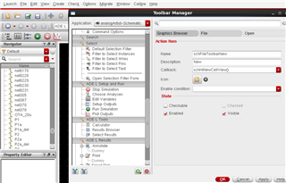

    Not really related to the problem but is there any improvement on the placement of Run Simulation and Stop Simulation on the tool manager menu. The problem is that they are placed closely so it is easy to mis-press them.
    Andrew Beckett over 7 years ago in reply to BaaB
    You can alter this yourself. Go to Window->Toolsbars->Customize in the schematic window (it should show "analogArtist-Schematic" in the Application choice at the top, and then scroll down to the "ADE L Setup and Run" toolbar section. If you then click on the Run Simulation icon line and drag it to the top of that section (over the "Choose Analysis" say), you'd then end up with a gap between them. You could also add a separator between them (with the green plus button at the bottom) but that doesn't add that much spacing. Hit OK or Apply and it saves the customisation into your home .cadence directory (if you hit the Reset... button on the form and then click on the "toolbar directory" hyperlink it shows you what has been customised and where it is saved).

    BaaB over 7 years ago in reply to Andrew Beckett
    Thanks. I dragged it to the top and then apply, OK but the Run and Stop Simulation button are still placed closely with each other.
    I guess that it may apply that setting when I restart the software. I can't restart now so I'll check if it works when I can restart it.
    Also I don't see the Reset button anywhere in the form.
    You don't need to restart Virtuoso, but the toolbars are only changed in new windows. So you could close the schematic window and then do Session->Design Window from the ADE window to bring up a new one - this should honour the new toolbar customisation.
    You didn't say which IC version you're using (the Forum Guidelines suggest you provide this information), but I'm guessing it must be quite old - I think the Reset button was added in an early IC616 hotfix version (Help->About in the CIW gives the version number)
