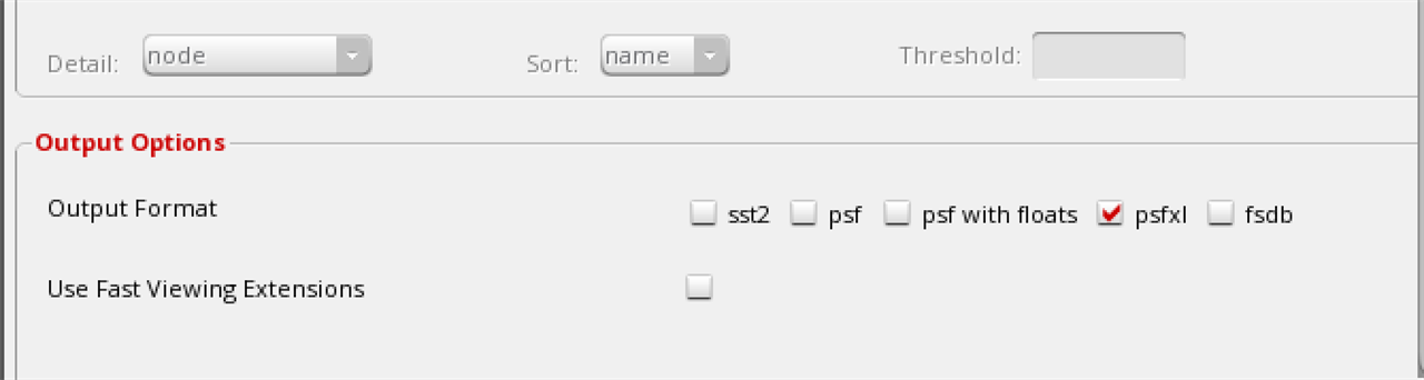

    As always suggested in the forum guidelines, knowing the version and tools you are using helps understand this kind of problem. As it is, I have no idea what version you're using, and I'm not going to cover every possible explanation for this for software versions from the last 25 years!
    Please provide that and also what output format you have chosen on the bottom of the Save->Options form in ADE.

    It's the bit at the bottom of the Outputs->Save All form (sorry, I said the wrong menu).
  • BaaB
    BaaB over 7 years ago in reply to Andrew Beckett
    It is same as the image.

    Well, given the fact that you are using an old and unsupported version (I don't know what version fo the simulator you're using too), I suggest you try just switching to "psf" in this case to see if that fixes it.
