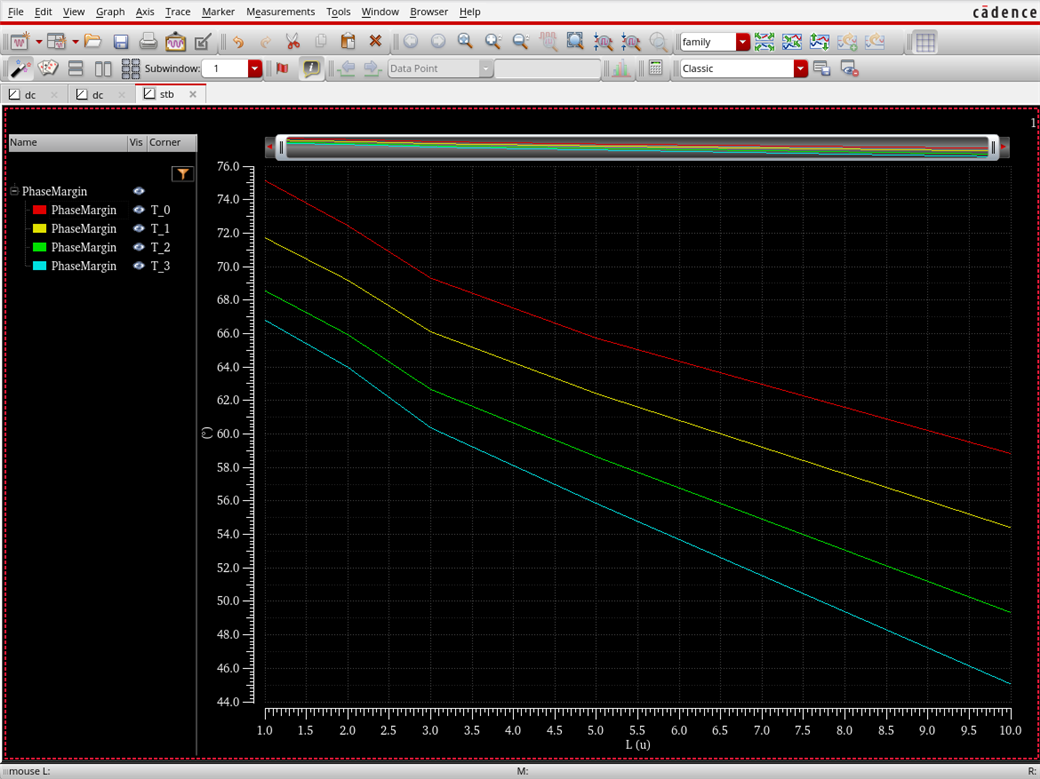

I encountered the following problem using cadence virtuoso IC6.1.8 ISR3 with SPECTRE 18.1 ISR6.
I did an stb analysis with a global variable sweep ("temperature" and "L"). Furthermore, I created several expressions for dc gain, phase margin and so on. The expressions are evaluated fine inside assembler. If I now right click on one evaluated expression for the phase margin and select "Plot All" I get the depicted window in VIVA - but the values do not match the expression results in assembler (They are somehow mirrored regarding the sweep variable "L").
Nevertheless, if I mark multiple phase margin results in assembler and click on "Plot" I get the correct results. I also attached a picture from that at the end.
This behaviour does not happen always, but it occurred several times to me.
Michael
Wrong plotting
correct plotting
    Michael,
    Not sure if this is a known issue or not (I’m travelling so can’t check) but I would recommend reporting this to customer support.  If it’s not known then we can investigate - if it is known at least we can tell you when a fix will be available (hopefully)

    Michael H over 7 years ago in reply to Andrew Beckett
    Hi Andrew,
    thanks for your quick response, I submitted a case.
    Michael
