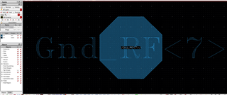

Hello everyone,
I have a layout in which a scalar pin exists. Now I want to change this pin to a bus pin. But if I try this, I get the error
Edit Properties
Cannot change terminal Name 'Vbb_lp6_PA' to 'Vbb_lp6_PA<0>'.
Error creating Terminal.
This problem I have very often. And my colleagues too.
Can anyone tell me, how to solve this problem?
Thank you very much!
Sascha

    your workaround does not help. Now I have deleted everything except one pin. The layout is totally empty! And this pin has a completely different name. But if I try to rename this pin, the error still occur. There must be something strange in this database. Is there a way to look inside this database? Or can I manually update this database? Or something else?
    Sascha

    Most likely there's either another pin on the terminal, or the terminal has been left behind (are you using VLS XL?). You can check by doing:
    cv=geGetEditCellView()
    term=dbFindTermByName(cv "THETERMNAME") ; where "THETERMNAME" is what you are looking for
    term~>pins
    If the last returns a list of db objects, there are still pins on that terminal that you might need to update to the intermediate name together. if not, you probably do dbDeleteObject(term) to remove it. Be careful in case you delete something you didn't meant to though!
    My workaround was to rename to something else, thus freeing up the terminal name and allowing you to name it back to a vectored name. However, that only works if nothing is still using the original terminal name.

    I tried your commands:
    but the error still occurs:
    If I try the workaround by renaming the pin to
    Vbb_1p6_PA_test
    then this works. But if I try to rename this to
    Vbb_1p6_PA<0>
    then the error occurs. AND if I try to rename it to
    Vbb_1p6_PA_test<0>
    then the error occurs too!
    Regardless which name I try, it is not possible to change a scalar pin to a bus pin. Even with the funiest name:
    For completeness: If I try to create e new bus pin with the name which leads to the error, then I get this error:
    Very strange!

    Dear Sascha,
    I had the same issue as you. I tried the Andrew idea, with no more success than you.
    I was trying to make a deleteAllPinsAndLabels function, because i was stuck with the vector vs scalar error (looping on 6911 pins) => press Escape 6911 time (phone in equilibrium on the key instead of killall -9 virtuoso did the job)
    ;--------------------- DELETE ALL PINS AND TERMINALS
    foreach(mapcar pins cv~>terminals~>pins foreach(mapcar pin pins foreach(mapcar LAB LABs=pin~>children  dbDeleteObject(LAB)) dbDeleteObject(pin))) ;<= did some stuf, but does not remove the visible rectangle in the layout
    ; PLUS delete signals :<= otherwise leCreatePin could fail if pins is named<0> from name : cannot be vector and scalar !
    foreach(mapcar s cv~>signals dbDeleteObject(s));<= rename from vector to scalar now possible
    term=dbFindTermByName(cv "Vout") ;=> db:....
    dbDeleteObject(term);=> (t)
    signals=setof(s cv~>signals s~>name=="Vout");=> (db:0x730cfb7f)
    foreach(mapcar s signals dbDeleteObject(s));=> (t)
    So i think the answer to your question is :
    foreach(mapcar s cv~>signals dbDeleteObject(s));=> (t)
