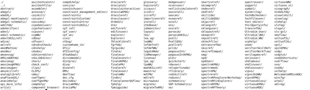

3. I actually have access to the latest document folder but I have difficulty to identify which one is the veriloga reference document same as the link above. Below is a screenshot of the documents that is available to me. Can you tell me which folder is for veriloga reference doc?

    The documentation for VerilogA is in the SPECTRE stream - if you do `spectre_root`/bin/cdnshelp you can access it that way, or look in the doc directory under the location reported by spectre_root (in a terminal) - it’s veriaref/veriaref.pdf

    I am able to find the veriaref files, thank you.
