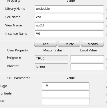

Hi, Officers,
I am running the IC6.17 and after I have add the analogLib components such as
But in the input.scs, it didn't show the independent source.

    That's quite odd. Some questions:
    • Are you using ADE L, ADE XL, ADE Explorer or ADE Assembler?
    • Are you using a config view or just the schematic?
    • If using a schematic, what do you have on the Setup->Environment form (particularly the switch and stop view lists at the top)?
    • What is the sub-version (Help->About will show this)?
    • Were there any errors in the CIW? If so, please post them here.

    Ruixin over 7 years ago in reply to Andrew Beckett
    Hi, Andrew,
    Thanks for your reply. I think your questions help me figure out the problems. I found out that the VDC cell that I used is auCdl instead of symbol. That's the error come out.
