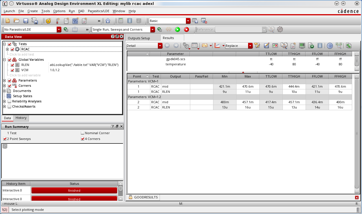

    OK, I put something together to illustrate this. I did it the way you were asking - which was for a lookup function rather than generating expanded corners. I think this should be fairly safe, and certainly works in the examples I've tried.
    The crux of it is two things - the table file (I kept the format simpler to make it easier to parse - no commas, just space separated, although I do allow for comment lines if they begin with a semi-colon). The first row is the names of the columns:
    ; first row is names of vars
    CORNER VCM RLEN
    TTLOW  1 9u
    TTHIGH 1 10u
    FFLOW  1 11u
    FFHIGH 1 9u
    TTLOW  1.2 15u
    TTHIGH 1.2 13u
    FFLOW  1.2 14u
    FFHIGH 1.2 16u
    Then I have this lookup function:

    Then you can see I use the function in the global variables section to look up a column from the table (in my case I only have one variable, but it could be used for multiple):
    The corners were set up like this:
    Finally, the complete example can be found here: https://community.cadence.com/cfs-file/__key/communityserver-discussions-components-files/38/lookup.tgz . This is using gpdk045 to provide a simple resistor. The design is in mylib/rcac/adexl (I originally was going to have a capacitor in there, hence the "rc" in the name, and it's only doing a DC operating point right now, but you get the idea).
