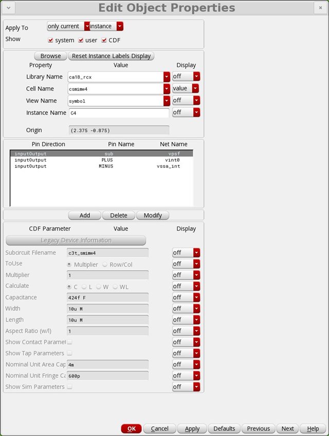

I have a capacitance symbol and I need to edit  the capacitance value of that symbol.  I do "q" to bring up the Edit Object Property form and try to enter the value.
However, I can't edit any value in that form. What would be the potential problem here ? how I can enable editable for those CDF parameters ?

    I include 2 pictures. First one is the one I have a problem to edit the value of parameters. The second one is the normal one.  You can see that I can't click on any button in the first picture so I can't edit any parameter value. Please help

    This is probably something you should consult whoever provided this technology, because it's almost certainly a function of their PDK.
    You can check in the CDF (Tools->CDF->Edit in the CIW) for the ca18_rcx/csmimw4 component, and for each of the parameters that you expect to be editable, check the editable callback. Presumably each is returning nil and hence the fields are not editable. You might want to compare it with the other component, ca18/csmim4 (different lib and cell name) to see if there's a difference. What is correct, I can't say as this requires knowledge of this specific PDK.
