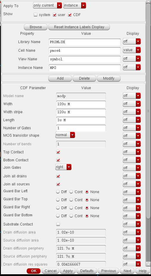

I start to work recently with Model Generator (ModGen) in Cadence Layout XL editor. The Cadence version is IC6.1.5 64 bit.
In order to interdigitate my matched array transistors with a specific pattern I need to define first the m-factor of the transistors, just an example I took this from Cadence help manual :
"......For example, if you have two devices with an m-factor of four, and you specify two rows with the base pattern of ABBA, you would create the following interdigitation pattern:
A B B A
A B B A.... "
If I don't set m then ModGen can not interdigitate my transistors.
However, there is no option I can see about  Multiplication Factor (m) from the instance properties as I have attached in this image. Then from where I can set this variable?
Thank you
Regards
  • RiadKaced
    RiadKaced over 6 years ago
    You need to talk to your PDK provider or look at the PDK documentation on why the M factor is not a visible/editable on this form. Ths m-factor is actually a special paremeter, you can always add it a s property and will be handled properly, but that's for advance users. In your case, your best bet is speaking with your PDK provider.
