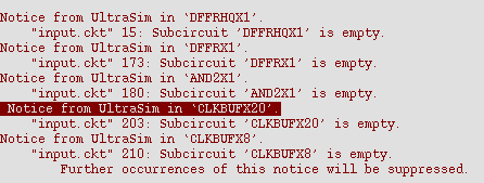

hello guys.
I am using IC 5.10.41.
When I used UltraSim simulator to run simulations on digital circuits, the simulation completed successfully but all the digital output voltages were 0;
I checked the log file and found the problem in the image below and I guess it is the reason why I did not get the right results.
I would appreciate it much if you can help me with this.
    Presumably you either have empty schematics for these cells (just the pins) or have included an external reference to these cells which are missing the contents. Without knowing what your simulation setup looks like, it's hard to pinpoint the problem.
