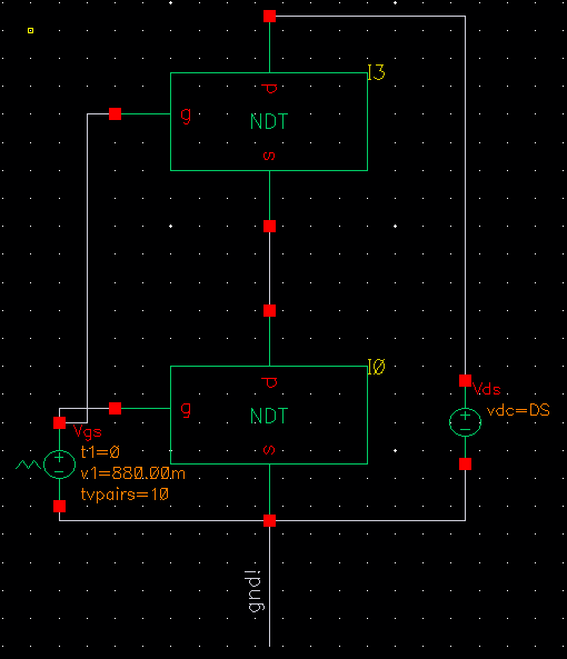

I simulated inverter with two verilogA table based models.
But it showed output value higher than Vdd value in some Vgs range.
I don't know what is problem, so I tried to change some parameter of the device.
I tried to insert data of resistance instead of current, but I could not find method to make device with Vds, Vgs, and R.
Is it possible to make transistor with these three parameter Vds, Vgs, and R without data of current?
This is verilogA code of the device.

Thanks.
