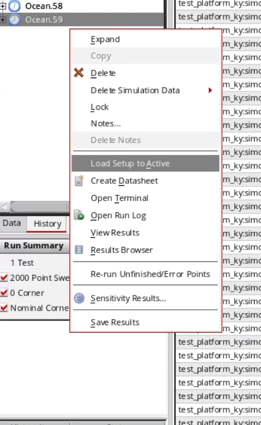

    1) After an ocean run, I do "Load Setup To Active" in my ADEXL window as shown below:

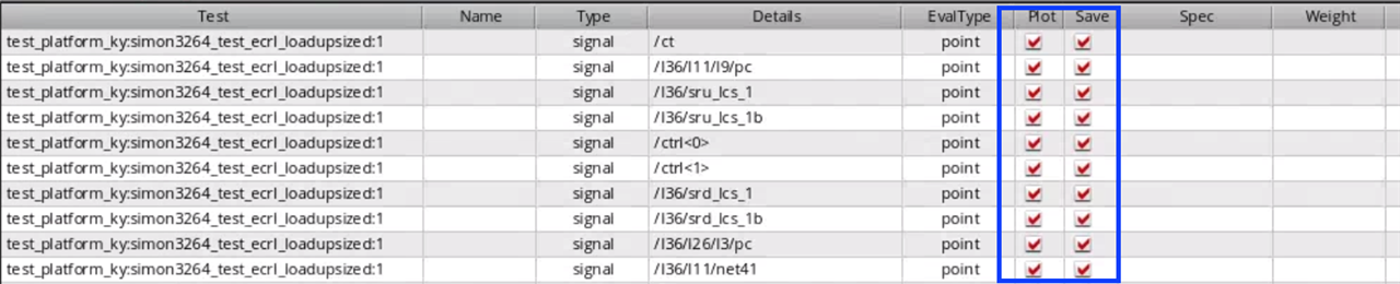

    (i) to enable to disable the existing plot/save options:

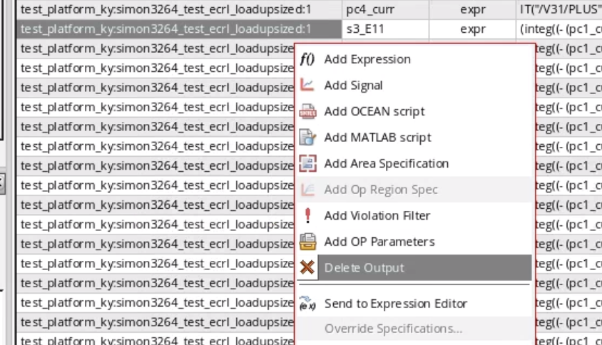

     (ii) delete the existing outputs:
    I am not able to do them and NO error pops up in the CIW window as well. Hope it is a little clearer now. Please let me know why this could be happening.
