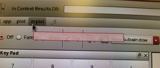

Hi All,
Usually, when hoving the mouse over a button, a menu or a blank space to fill, a rectangle information balloon popup to provide information about the function or what information is expected when filliing a form.
I'm using  6.1.7, and in the current setting the background color is pink and the text is white so that the information are completely unreadable. (pic below)
Does anyone knows where to modify this background color?
Thank you
Regards
KC
    Check out this article: Plasma desktop on KDE: Tooltips in virtuoso unreadable with system default setting of white Tooltip Text (there's also another linked article at the bottom of that which may help).
  • isazulkc
    isazulkc over 6 years ago in reply to Andrew Beckett
    Hi Andrew,
    Thanks a lot! The issue is now fixed, following the instructions of your post.
    Best regards
    -KC
