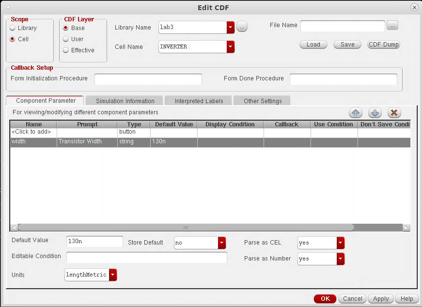

I am trying to generate a symbol with a variable parameter. For instance, I have an inverter with the NMOS width set to : pPar("width") and the PMOS width set to: 2*pPar("width").
I have gone through the CDF window to edit the parameter using the base CDF layer. (See picture for reference)
CDF parameter window

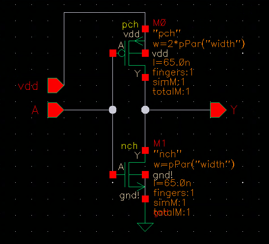

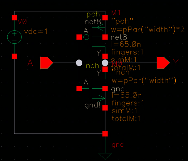

Here is the schematic of my simple design:
Schematic of simple inverter with parameter as width.

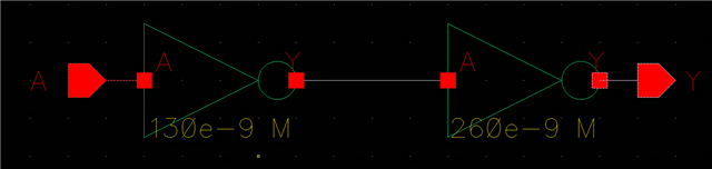

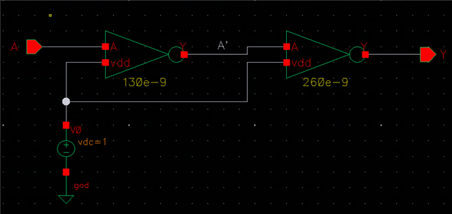

And here is the schematic using the instantiated inverter as a symbol:
Instantiated inverter symbol.

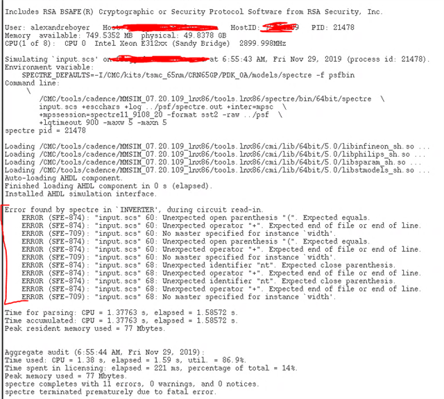

When I try to run a simple simulation using Spectre, I get the following error:
Output error of the Spectre simulation.
I am wondering what I am doing wrong.

    Hi Alexandre,
    Can you please post lines 59-61 and 67-69 of the input.scs so it's clearer which lines are causing the problem?
    Ideally, if the circuit is just as you've shown it, providing the entire input.scs would help. The netlist itself (rather than a screenshot) is preferable (as it's then searchable).

    Andrew Beckett over 6 years ago in reply to AlexandreBoyer
    Hi Alex,
    The issue is with the lines:
    nrd=(1-int(1/2)*2)*(1e-07*1e-07/(1e-07+1e-07*(1-1))/width)+((1+1)nt((1+1)/2)*2)*(1e-07/1/width) \
    nrs=(1-int(1/2)*2)*(1e-07*1e-07/(1e-07+1e-07*(1-1))/width)+((1+1)nt((1+1)/2)*2)*(1e-07*1e-07*1e-07/(1e-07*1e-07*(1-2)+1e-07*(1e-07+1e-07))/width) \
    These exhibit the classic sign of a problem that occurs if using an old (pretty old) version of IC6.1.X on a newer operating system (so you're possibly running on an unsupported OS). I think it's an issue that was resolved in IC6.1.5 ISR12 (so 6.1.5.500.12), and given that you're running a spectre version from 2009 (MMSIM7.2), it wouldn't surprise me if you're using a very old IC version.
    So can you report what Help->About returns (please give the entire subversion number) and also what "lsb_release -a" returns if you type it in a terminal window?
    Thanks,
    Andrew Beckett over 6 years ago in reply to Andrew Beckett
    BTW, I should point out that this was because of an incompatible change made in the Linux OS (in the C libraries) and we had to adapt the software to deal with it, if it's what I think the problem is. Hopefully I can give you a workaround if the issue is what I think it is.
