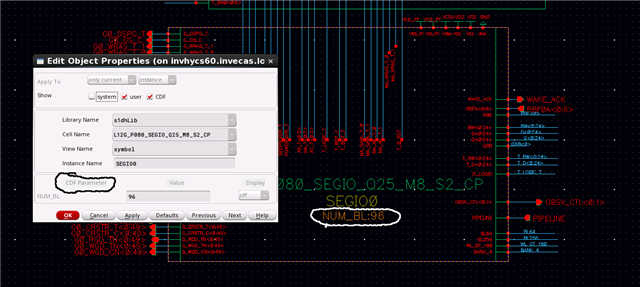

Hello All,
In Virtuoso schematic how do I  setup up "rules check" to give error during netlist out in case of missing CDF param ?
ICADV12.3-64B
Thanks.
    What do you mean by "missing CDF param"? I don't understand the requirement...
  • roopakvasa
    roopakvasa over 6 years ago in reply to Andrew Beckett
    Hi Andrew,
    In above snapshot we define NUM_BL param which is used as we decend inside to compute some equations.
    But if we have defined these parameter in netlist and simulate, equations inside the hierarchy can not computed and we get error as below:
    Error found by spectre in `L12G_P080_SEGIO_Q24_M8_S2_CP':`XSEGIOX2.XSEGIO1', in `L12G_P080_SEGIOX2_Q49_M8_S2_CTP':`XSEGIOX2', during hierarchy flattening.
        ERROR (SFE-1997): "netlist.sp" 2193: XSEGIOX2.XSEGIO1.XT0: parameter `l': Cannot run the simulation because an unknown parameter `NUM_BL' has been specified in expression `(NUM_BL-20)*BC_HEIGHT'. Correct the expression and rerun the simulation.
    So I want to avoid such case in a way like netlist out should fail if parameters are not defined.
    Thanks.
    Andrew Beckett over 6 years ago in reply to roopakvasa
    You could use this code to detect this and error out during netlisting:
    /* abErrorOnMissingParameter.il
    Author     A.D.Beckett
    Language   SKILL
    Date       Dec 18, 2019
    Modified
    By
    Example of checking for missing parameters used in expressions.
    For example, if you use pPar("someName") in an expression, but then
    "someName" is not defined in the CDF - this will lead to a simulation
    error normally. With this code, it will error at netlisting time instead.
    The code as provided will not error out of the CDF parameter has been
    defined, just not assigned a default value. In that case, if the
    user still doesn't specify a value on the instance of the cell, it would
    still fail with a simulator error - the problem is that otherwise you
    have to detect all sorts of other special cases which would be rather
    hard.
    To register the checker, use:
    abRegisterMissingParamSpectreFormatter()
    Note for ADE XL, Explorer and Assembler, the code must be loaded and the
    registration function called within the .cdsinit (not just the CIW)
