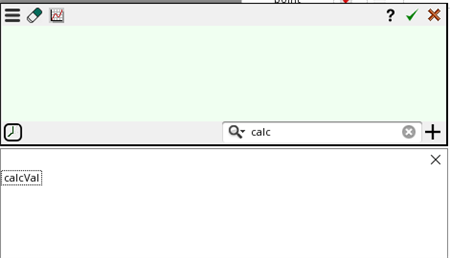

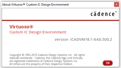

    Here is my version. Isn't it the latest one?
    I am not able to see that function:
    Andrew Beckett over 6 years ago in reply to noramirkh
    Unfortunately not. That's ISR2 (the 500.2 on the end indicates this; you'd need to use at least 500.7 which is a later hotfix). Even then calcValForRel doesn't show up in the expression builder - you'd just need to type it in with the right arguments. You can find it by typing startFinder() in the CIW and searching for calcValForRel and then hitting the more info button (this too would require ISR7 or later). It mostly shares the same arguments as calcVal with some extra to enable the aging information.
