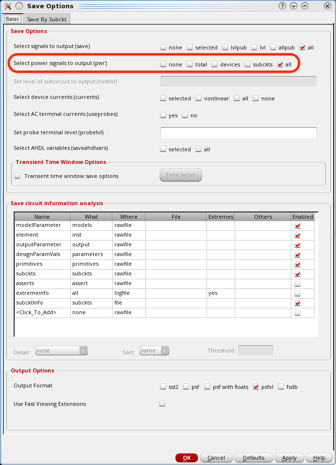

how to calculate avg power
balapavan
balapavan over 6 years ago
I need to calculate average power in transient analysis using cadence tool, but in tran option i am not getting pwr signal. what is the problem behind that??
    You probably didn't enable the saving of power from the Outputs->Save All form (I picked "All" here, but maybe you only need subckt depending on how many different elements you need the power computation saved for):
