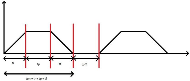

2. Modified Circuit
Now the same circuit is modified with a switch added with the resistor Ron.
The switching wave is given below.
Now during ton, the Loop gain (AB) is same as before (including Ron, since the switch is closed). But during toff, the Ron is inneffective and the loop gain is changed as shown below
AB = (Adc*Cf*po)/ s(Cin+Cf)) + (Cin+Cf) *po
There is only one pole now
P = -po
But how can I comeup with an overall transfer function considering the swtching waveform. That means for ton, I should have the same transfer function as case1 and during toff  should have the transfer function as case2. Also, the switching wave is periodic with period = ton + toff.
If someone know this how to model the transfer function, it will be helpful. Because, the stability analysis shows diferent results for both cases. I assume that this is due to the two different transfer functions.

  • ShawnLogan
    ShawnLogan over 6 years ago in reply to Jaikrishnan
    Dear Jaikrishman,
    I happened to have taken a couple of courses many years ago taught by two pioneers in the switching converter analysis effort. I think the methodology they proposed is appropriate for your circuit. Basically, Dr. Cuk and Dr. Middlebrook proposed a method to create a state-space model for a circuit that has two distinct state space relationships. In summary, the effort involves, as you have done, modeling the transfer function of each mode of operation separately, and then combining the two in a manner proportional to the time over which the circuit state exists in each of the two modes. Dr. Cuk PhD thesis proposes this and is followed on with a more concise paper by Dr. Middlebrook and Dr. Cuk in 1976 entitled "A general unified approach to modelling switching-converter power stages".
    I might suggest you refer to this paper, available from IEEE, for the details. However, the method is rather straightforward and you may be able to understand enough of it from my description to proceed.
    Shawn
