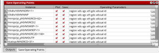

We can find the  transient operating point of MOS device (see as below)  with non-extracted or pre-layout  netlist.
But, how it can be done when we are using extracted netlist (spf view of the block).
    Whilst we have added some stuff recently to support mapping of saved nodes into corresponding nodes in DSPF (this was added recently in IC618) I don't think the same has been done for saving operating point parameters this way (I may be mistaken, but I don't think it's been done). I would suggest contacting customer support as then we can check the status and if not file an enhancement request to cover that part too.
    In the meantime (you're using an older version; I can tell because the UI has changed), you would have to write some save statements in an include file, giving the name of the device in the DSPF file with the correct hierarchical name into the DSPF. I imagine that the DSPF might be flat, so you can uncover the instance name by looking into the DSPF and then it will be ITOP.someName:gm etc that you are saving (ITOP is whatever is the hierarchical name, using dot as hierarchy separator, of the instance of the DSPF block).

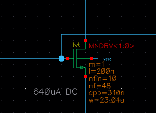

    I followed the steps you have suggested. My extracted top cell name is clkdiv and its spf netlist has the following lines.  I need to find the transient operating point of the device MMNDRV0.
    Though in schematic the device MNDRV is --> MNDRV<1:0> with 48 fingers.

    IN the instance XI69 schematic the device is like :-
    and the more portion of the big netlist is as below:-
    Andrew Beckett over 6 years ago in reply to RFStuff
    OK, the question is really what the MNDRV instances are called in the DSPF. You need to find those instances in the netlist - maybe they are not hierarchical (often transistor level DSPF is flat and doesn't have hierarchy in - so it might be clkdrv.MXXI69\/MNDRV0 - without knowing what the name is in the DSPF I can't guess.
    One approach you could take is this. Add this row into the Outputs->Save All form and then you'll end  up with a text file with all the hierarchical instance names (plus other info) at the location you want.
    Judging by your other append, I think you (maybe) want:
    clkdiv.XXI69\.MMNDRV1\<0\>\@20:region
    You're going to need to escape any unusual characters. It's not obvious to me though whether the . in the instance name causes a problem. As I said, the best thing is to do this via support as a little experimentation might be needed - seeing the actual files rather than screenshots would really help.
