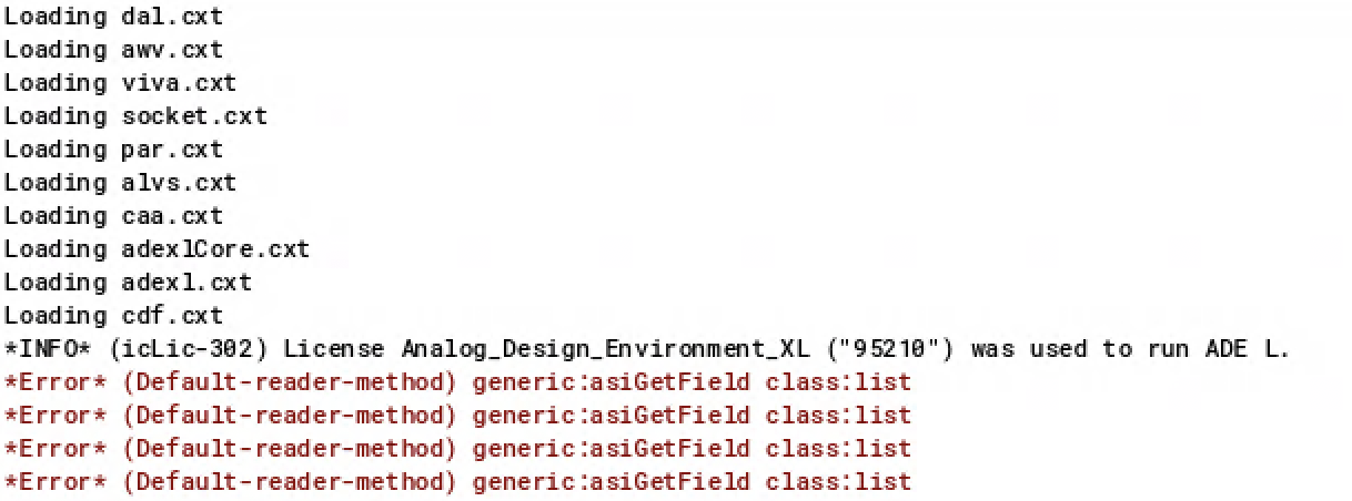

I am trying to use ADE L to run DC and AC simulation, but when I click "analyses" => "choose", it shows the following error:
*Error* (Default-reader-method) generic:asiGetField class:list
my virtuoso version is ic-6.17.710

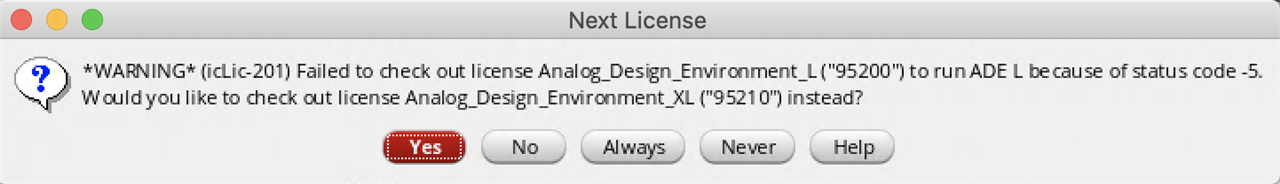

    (1) when I launch ADE, it asks me to use another license
    (2) the virtuoso. command window

    Andrew Beckett over 6 years ago in reply to Archon
    Which simulator are you using? Does this happen when opening existing ADE states, or just new ADE windows? Does it still happen if you use “virtuoso -nocdsinit” to start Virtuoso?
    Probably customer support is the best way forward here if the above questions don't reveal anything obvious.
