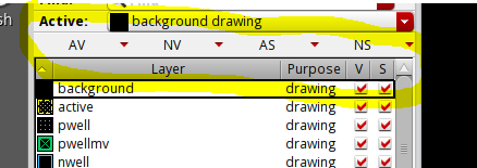

How set "control buttons" enabled by default inside Palette
MauroF
MauroF over 6 years ago
is there a way to set visible the "control buttons" as default at each Virtuoso session? I search for some varibale to set but I didibn't find anything
Regards
Mauro
    This is saved under the workspace. The default behaviour is normally to have these displayed, but if you disable the control buttons and then save the workspace (in the workspace toolbar) it will remember the sub-assistant settings like this as part of the workspace.
