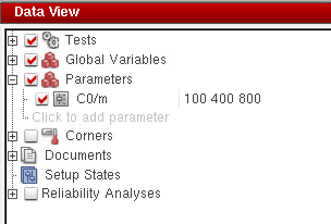

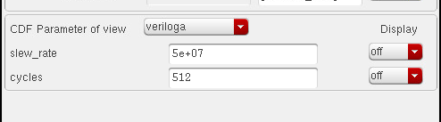

    I want to set a veriloga parameter from ADE XL, by adressing the parameter directly and not by using a global variable.
    I have the parameters "slew_rate" and "cycles" in my veriloga block, I would like to sweep the parameter "cycles".
    When I am not using a State File for my simulations I could sweep "cycles" by putting in a global variable name instead of "512", and sweeping the value of that global variable.
    When starting transient simulations from a State File in ADE XL, sweeping global variables no longer has an effect in simulations.
    So I can no longer use the approach of putting in a variable instead of "512".
    But if I could set the value of the parameter "cycles", as I do for the multiplier of capacitor C0 below, then I should be able to sweep the parameter cycles while using a state file.

    I went to customer support, but before submitting a case I found documentation that helped me.
    What I needed to do was to edit the CDF of the veriloga block, as it had been generated in a way such that the Variables and Parameters toolbar in ADE XL could not see the parameters.
    Editing the CDF allowed me to access the parameters of the veriloga block, and I am now sweeping while starting simulations using State Files.
