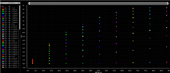

Hello Cadence,
I am trying to plot the 3db point while varying the number of fingers and the finger width of two MOSFETs, I really only have the two variable though since the second mosfet matches the first one.
For some reason when I plot this after running adexl I only get points, It doesn't connect the dots, my guess is maybe there are too many variables; I haven't had this problem before. I guess my general question is how can I prevent this from happening? Also, how can I fix this in VIVA if I am to run into this problem again?
Thanks!
Charles

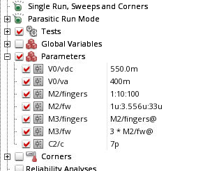

  • Cdub
    Cdub over 6 years ago in reply to ShawnLogan
    Thank you Shawn for the reply. I was hoping for a way to do it all in ViVA, or adexl. I am editing M2.fingers and M3.fingers in the parameters section where I just set M3.fingers=M2.fingers and M2.fingers is between 1:1:100.

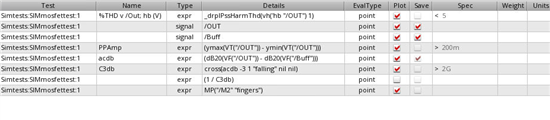

    Please can you show an image of the parameters section in the Data View assistant so I can see the sweep setup more clearly? Also please show the expression that you're trying to plot in the outputs. This will help in trying to reproduce the problem and understand a way around it (otherwise I might guess and find something that works anyway).
    Also, please report what subversion of the IC tools you're using - Help->About will report this (or type getVersion(t) in the CIW).
    Thanks,
  • Cdub
    Cdub over 6 years ago in reply to Andrew Beckett
    That would be great! I have attached the pictures of my parameters and tests. I'm using IC6.1.7-64b.500.1; What do you think?

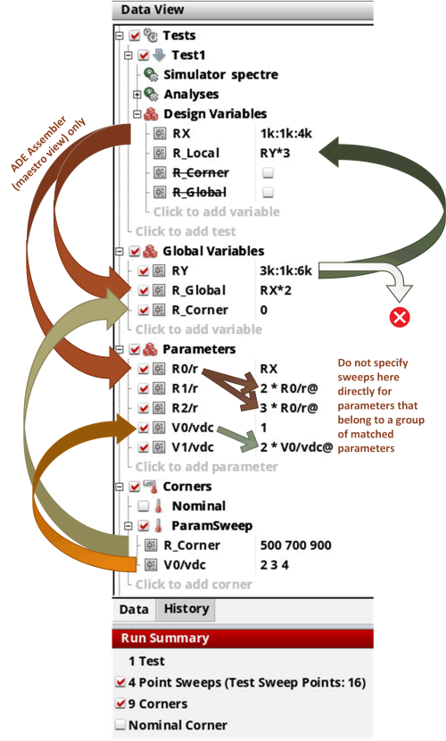

    Dear Cdub,
    I have encountered the same problem many times when playing with global variables being arguments in other global variables. The only option I knew up to now was to reduce number of variables to one and compute dependent variables in the schematic directly (e.g. specify WW variable and set the width of one transistor to 2*WW, another one to 3*WW etc. - stupid but simple example).
    I tried these versions to find a solution:
    • IC6.1.6-64b.500.11 (ADE XL)
    • IC6.1.7-64b.500.7 (ADE XL, ADE Assembler)
    My conclusions after playing with probably all possible combinations are as follows:
    • By "parameterized" I mean an item that has sweep range defined instead of a single value
    • Do not use parameterized Global Variable as an argument in other Global Variable or Parameter
    • Do not parameterize a Parameter directly if its value is used by other (i.e. matched) Parameters
    • IF NECESSARY:
      • Parameterize your Global Variable(s) and/or Parameter(s) using Corner definition
      • You can parameterize Global Variable and use this global variable as an argument in Local (i.e. Design) Variable(s)
      • [ADE Assembler (maestro) only] you can parametize Local Variable and use it as an argument in both Local and Global Variable(s)

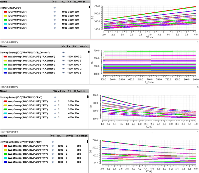

      • Order of parameterized items matters when it comes to plotting. From my experience, an item that is last on a list (last parameterization in corner, in this case) is used for the X axis by default in ViVA. You can change it by reordering before simulation, or clicking RMB on an X axis and selecting: Swap sweep variable.
    Here's an example, which I tried to make simple but complete:
    Schematic of two voltage sources and six resistors connected in series
    And here's what you can (and can't) do to avoid the problem you describe (and similar issues with Global Variables):
    ADE Assembler settings
    Here is a not-so-meaningful simulation result demonstrating that results can be plotted against all four parametric sweeps that are defined and no reduntant, repeated parameters are present (that result in plotting many single-point "traces" instead of smaller amount of desired continuous line traces):
