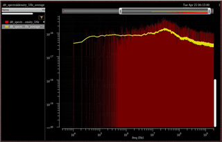

I am using ADE-XL and am doing DFTs. I would like to know if I can get a smoothed DFT by for instance making a moving average with a couple of given points (let's say 10) ? as I would need to overlay it to an ideal AC Noise density.
I would like to get the smoothed dft accessible in my ADEXL Results..

    I suspect you really want to use psd instead of dft in that case, to compute a Power Spectral Density. If you want a moving average function, you could use article 11613392 (although I've never tested this on non-time domain data), and article 11609072 gives a way of changing the plot style so it's continuous for example.

    Obviously the verilog-A function you mention computes the moving average of a signal over time; but in my case I already have a dft and would like to smooth it, by computing the average of the 10th previous points each 10 points...

    The function I pointed to is not a Verilog-A model - it's a calculator function which works over the x-axis and so probably doesn't really care whether it's time or not (the comments in the code say this). I've not tried doing it on frequency domain data, but I think it would work. The code was inspired by a Verilog-A model (the article references that) but apart from that, it doesn't require you to do it on time domain data.

    the abMovingAvg function is quite effective!
