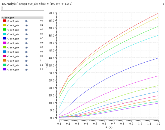

I am characterizing a  BSIM4 MODEL (V4.5). In my variable mapping, I have different dc parameters to be mapped and one of them is self_gain with the unit of rall.
When I run the code, I get an error that says that Reference to non-existent field 'rall'.
My Cadence virtuoso version is: IC 6.1.8-64b.500.9 and my spectre version is 19.1.0.237.isr3
Perhaps there might be a change of unit that I am not aware of.
I have provided more details below. Any idea how to proceed with this issue?
Thanks for your help.

    Thank you for your prompt response. I am attaching the Matlab code. I am running techsweep_config_bsim4_180_spectre.m by using techsweep_spectre_run. Inside,   techsweep_config_bsim4_180_spectre.m, code line # 56 and #78, I have DC parameters 'mn:self_gain','rall'and 'mp:self_gain','rall', where the parameters are self_gain and their units 'rall' respectively. My question is what is the unit of the DC parameter self_gain? If you do a simple DC sweep of NFET or PFET and go to result > print > operating point and click on the transistor, you see, self-gain listed as one of the parameters.

    self_gain has no units (it's a gain, so it's dimensionless). I've not worked out what your MATLAB code is doing (I'd have to try to create some fake models to emulate what your code does, assuming I can find some time to look at it), so I've not tried to work out why you have this 'rall' value in the code. Presumably you wrote it, so why did you put 'rall' there?

    Anyway, I did some experiments with a simple netlist where I did a dc sweep of a bsim4 model and saved all the operating point data in the dc sweep. I'd already checked an info analysis from a dc operating point and found that self_gain was unitless, but with a dc sweep as follows:
    model nch bsim4 type=n
    Vd (d 0) vsource dc=1.2
    Vg (g 0) vsource dc=1.0
    M1 (d g 0 0) nch w=1u l=0.2u
    sweep1 sweep param=dc dev=Vg start=0.1 stop=1.2 step=0.1 {
      dc dc dev=Vd start=0.1 step=0.1 stop=1.2
    //  dcOpInfo info what=oppoint where=rawfile
    save M1:oppoint
    the self_gain has a unit of "-real" in the PSF data (see the y axis in ViVA):
    I assume the minus is because real is probably a keyword in PSF.
    Anyway, for some odd reason (probably because the "-" is a special character in MATLAB) this gets translated into "rall" by cds_srr (there's no usage of cds_srr in the code  you posted, but I assume you're using that). I don't know why it gets translated to rall - this seems peculiar to me:
    >> data=cds_srr('testbsim4.raw','sweep1_dc-sweep','M1:self_gain')
    data =
    struct with fields:
    info: {'rall' '' 'dc' 'V' 'Vg_dc' 'V'}
    Vg_dc: [0.1000 0.2000 0.3000 0.4000 0.5000 0.6000 0.7000 0.8000 0.9000 1 1.1000 1.2000]
    dc: [12×1 double]
    rall: [12×12 double]
    So if you're needing the field to access, it's called rall . I don't know what your real problem is though because you've not provided enough code or shown the error you're getting.

    The unit of self_gain is real and it is working now.
    Thank you very much indeed.
    Andrew Beckett over 6 years ago in reply to wgtkan
    No idea why - I managed to download the code you posted before you deleted it, and it works for me as-is (with 'rall'). In fact it fails if I change it to "real". Maybe this was dependent upon the version of MATLAB you're using (I was running R2019a as it was what I happened to have installed on my laptop). I used the same spectre version as you.
