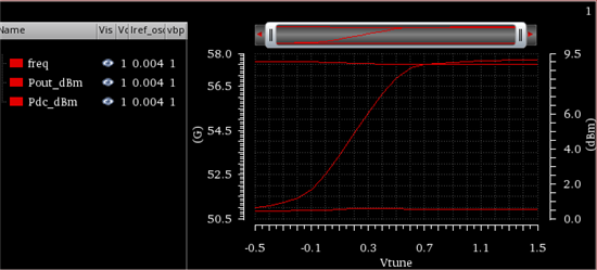

Exporting a waveform into a vcsv file returns the error:
The wsSaveTraceCommand command generated an exception basic_string::_S_construct null not valid.
Only the first row of the vcsv file is created (";Version, 1, 0"). This was the first time I've exported waveforms generated with Assembler. I had no issue before with the combination of ADE L, Parametric sweep and ViVA XL. My project uses ICADV 12.3. I have not found any related forum entry or documentation. How could I export the waveforms in vcsv? Exporting the values into a table and then exporting into a csv works, but my post-processing script was written for vcsv format.
    I did a little internal searching, and found an explanation (personally I think we ought to handle this more gracefully). The answer was:
    The error occurs when the waveform being exported does not have a name associated with it. The name is an internal attribute that is setup by the ADE plotting flows after expression evaluation/data access.
    So it may be that your output expressions in Assembler need to have a name specified, and then the error might go away? Can you check that, and if so, maybe contact customer support to suggest that we handle it more gracefully (because it's not obvious a name is required). Of course, if adding a name doesn't work, then also contact customer support!

    I have found another difference. Saving a waveform works as expected if I export a wave family of the same expression. But once I move a few selected waveforms into a new subwindow - example in the picture - and export them into a vcsv file, then the error pops up.
    Andrew Beckett over 6 years ago in reply to ZoltanT
    OK - suggest you contact support because clearly there's some buglets here...
