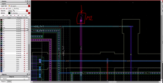

Hi all,
I have troubles using the Mark net tool, maybe you could help out.

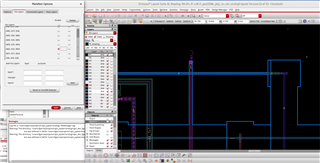

In this example for the test I try to highlight a simple net (that does not propagates too much in the layout) called "pwr_i", here in metal 2 (purple).
I do: Connectivity > Mark net, and then press F3, and in the MarkNet Options windows go in Via Layers tab and -for the test- deselect all but (M2) (V2) (M3).
The result is plenty of other unattached signals are highlighted: in this example you can see the "en" signal (horizontal) and even the thick exclude layers (on the left) are highlithed as well...
What do I do wrong ?
Thanks for your help and best regards
    Rather hard to see what the original layout looked like, but the large regions at the right and bottom, what layer are they one? Is it some purpose of M2 or M3 (rather than a specific blockage object)? If so, since the mark net is set up to be layer based, it's going to see those as being the same materials:

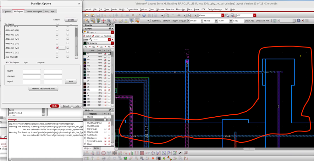

    Andrew Beckett over 6 years ago in reply to threepwood06
    So what is that white-ish/yellow-ish layer (in the area which I drew the red highlight around)? You said "exclude layers" but I don't know what they actually are? I suspect they are key to the problem.

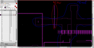

  • threepwood06
    threepwood06 over 6 years ago in reply to threepwood06
    In this screenshot I show only M2 drawing and M2 exclude layers:

    I have found the answer.
    In the MarkNet option window > Options tab, one can simply add "exclude" in Exclude Purposes, and it does the job fine:
    End of the story.
