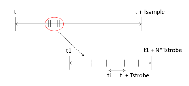

    Let me try to answer your question as best I can to explain my comment. Even when you measure the "noise during a defined time window", you are imposing frequency limits on your rms measurement. Why? Suppose you measure the noise over a time period Tsample with measurements of the noise taken every Tstrobe interval within that time window Tsample as shown in the attached illustration. The fact that you are observing the noise over a total time period of Tsample suggests that your measurement will not fully capture the contributions of noise whose frequencies fall below 1/(Tsample). Simply put, you will only capture a portion of the noise whose frequency components is less than 1/(Tsample). Now consider the effect of Tstrobe on your noise measurement. If the noise has frequency components that exceed the frequency of 1/(Tstrobe), it also will not be accurately captured in your noise measurement. As a result of this explanation, hopefully you will agree with me that the use of a 1 us time period to measure your noise and whatever value of Tstrobe your simulation data provides, does not capture the full rms noise power.  In fact, the noise power of even thermal noise is infinite over the full frequency band. Hence, any real noise measurement has in inherent limited bandwidth. This is the basis for the use of the thermal noise estimate of -174 dBm/Hz in a 50 Ω system at room temperature.

    While the integration over time and frequency in Parseval's theorem are infinite, the signals in time and frequency do not have to extend to infinity in their respective domains. In the example I provided, the noise frequencies are limited by the filter corner frequencies of 1/(Tsample) and 1/(Tstrobe). The time domain data is also limited by Tsample and Tstrobe. Hence, the time and frequency signals of the two integrals are not infinite.
    Let me know if this helps explain my comments a bit better.
