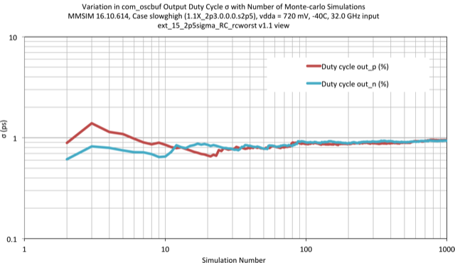

    For your information, my approach to answer your question regarding what is considered a “sufficient” number of Monte Carlo simulations is to initially perform a very large number of Monte Carlo simulations on a small circuit whose statistical behavior mimics the circuit under study. If your circuit under study is small, you could simply use it. Using the raw output data for the parameter of interest, I compute the estimate of the standard deviation as a function of the number of simulations and plot the result. I have attached an example of such a result. From this data, and knowing the statistical requirements for your estimate of the standard deviation, you may better estimate the number of Monte Carlo simulations to perform.
    Does this address your question?
    Shawn

    Thanks for your reply.
    I will work with this strategy.
