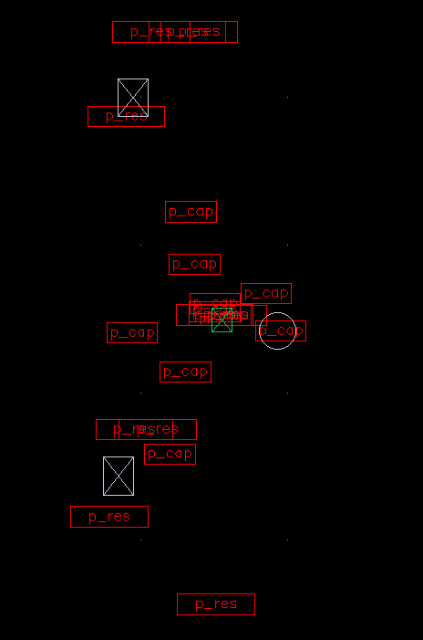

I have run parasitic extraction on a simple inverter in a new technology that I have. After running the post layout simulation using Assura, the main transistors are missing in the analog extracted view. I have also checked the netlist and there are only the parasitic resistances and capacitance. What do you think might be the issue? Is it from the technology file?
Mehdi
  • Mehdi Nasr
    Mehdi Nasr over 6 years ago
    Here is the netlist after and before the post layout and also the screen shot of the layout and post layout for your reference:

    Andrew Beckett over 6 years ago in reply to Mehdi Nasr
    A little note - you posted some previous questions at the end of last week, and then as I was about to reply to them (having done some research and composed by response) you deleted the post. Please don't do that, because it's really irritating when you suddenly find the post has disappeared. Better to post another entry in the thread explaining how you resolved it. Because of that I wasn't particularly keen on breaking my weekend to reply sooner to this one...
    Not sure what the cause is here. I'd suggest checking the log file for any warnings - it may be the mapping is wrong (see also Basics and Frequently Asked Questions or Issues during generation of extracted view from Quantus). Do the transistors show up if you ask to generate SPICE rather than extracted view?  If they do, and not in the extracted view, my guess is that something is wrong about the mapping to the PDK transistors.
    Probably best to contact customer support.
  • Mehdi Nasr
    Mehdi Nasr over 6 years ago in reply to Andrew Beckett
    Andrew,
    Thanks for your comments and points.
    I have checked the spice netlist running but unfortunately the QRC fails, so I cannot run to check it out. I have sent the simulation files to the foundry and they could run it properly, even they do not know what's happening. I have also checked the Assura and QRC version and it is also the same to them. Please let me know if you have any other suggestions or not.
    MEhdi
    You might also want to contact customer support, because it's hard to talk about specifics of the TSMC technology you're dealing with here when we can't really discuss that in public without potentially breaking NDAs. It may be that you have too old a version of the kit, or it's not been configured properly - talking to TSMC should help with that too.
  • Mehdi Nasr
    Andrew,
    Thanks for all of your supports. I contacted the foundry (XFAB), they can easily run my test bench and extract the parasitics. They suggested me a couple of things, I considered them but It is not fixed yet. Last option was installing the PDK based on the latest updated versions. Not only it did not fix, but also QRC even does not run and it fails this time. Here is the error that shows that the reference node seems is not correct, but it is exaclty what I have on my schematic.

    ##ADD_BULK_TERMINAL=N
    ##AGDS_FILE=/dev/null
    ##AGDS_LAYER_MAP_FILE=/dev/null
    ##HCCI_DEV_PROP_FILE=/dev/null
    ##AGDS_SPICE_FILE=/dev/null
    ##AGDS_TEXT_LAYERS=
    ##ARRAY_VIAS_SPACING=
    ##ASSURA_RUN_DIR=/ECEnet/home/student/mehdina94rm/XFAB_XT018/AssuraDRC
    ##ASSURA_RUN_NAME=voltage_limiter_conventional_mn_DRC
    ##BLACK_BOX_CELLS=/dev/null
    ##BREAK_WIDTH=
    ##CAP_COUPLING_FACTOR=1.0
    ##CAP_EXTRACT_MODE=coupled
    ##CAP_GROUND=gnd!
    ##CAP_MODELS=yes
    ##DANGLINGR=N
    ##DENSITY_CHECK_METHOD=P
    ##DELETE_OUTPUT_FILE=N
    ##DEVICE_FINGER_DELIMITER='@'
    ##DF2=Y
    ##DRACULA_RUN_DIR=
    ##DRACULA_RUN_NAME=
    ##ENABLESENSITIVITYEXTRACTION=N
    ##EXCLUDE_FLOAT_LIMIT=
    ##EXCLUDE_FLOAT_DECOPULING_FACTOR=
    ##EXCLUDE_FLOATING_NETS=N
    ##EXCLUDE_NETS_REDUCERC=/dev/null
    ##EXCLUDE_SELF_CAPS=Y
    ##IGNORE_GATE_DIFFUSION_FRINGING_CAP=Y
    ##EXTRACT=both
    ##EXTRACT_MOS_DIFFUSION_AP=N
    ##EXTRACT_MOS_DIFFUSION_HIGH=
    ##EXTRACT_MOS_DIFFUSION_RES=Y
    ##FILTER_SIZE=2.0
    ##FIXED_NETS_FILE=/dev/null
    ##FMAX=
    ##FRACTURE_LENGTH_UNITS=MICRONS
    ##FREQUENCY_FILE=/dev/null
    ##GROUND_NETS=
    ##GROUND_NETS_FILE=/dev/null
    ##GROUND_SUBSTRATE_FLOATING_NETS=N
    ##HCCI_DEV_PROP=7
    ##HCCI_INST_PROP=6
    ##HCCI_NET_PROP=5
    ##HCCI_RULE_FILE=
    ##HCCI_RUN_DIR=
    ##HCCI_RUN_NAME=
    ##HEADER_FILE=/dev/null
    ##HIERARCHY_DELIMITER='/'
    ##OUTPUT_HIERARCHY_DELIMITER='/'
    ##HRCX_CELLS_FILE=/dev/null
    ##IMPORT_GLOBALS=Y
    ##LADDER_NETWORK=N
    ##LVS_SOURCE=assura
    ##M_FACTORR=
    ##M_FACTORW=N
    ##MACRO_CELL=Y
    ##MAX_FRACTURE_LENGTH=infinite
    ##MAX_SIGNALS=
    ##MERGE_PARALLEL_R=N
    ##MERGE_PARALLEL_VIA=N
    ##MINC=1e-17
    ##MINC_BY_PERCENTAGE=0.1
    ##MINR=0.001
    ##NET_NAME_SPACE=layout
    ##NETS_FILE=/dev/null
    ##OUTPUT=/ECEnet/home/student/mehdina94rm/XFAB_XT018/AssuraDRC/voltage_limiter_conventional_mn_DRC/extview.tmp
    ##OUTPUT_NET_NAME_SPACE=layout
    ##PARASITIC_BLOCKING_DEVICE_CELLS_TYPE=gray
    ##PARASITIC_CAP_MODELS=no
    ##PARASITIC_RES_MODELS=no
    ##PARASITIC_RES_LENGTH=N
    ##PARASITIC_RES_WIDTH=N
    ##PARASITIC_RES_WIDTH_DRAWN=N
    ##PARASITIC_RES_UNIT=N
    ##PARTIAL_CAP_BLOCKING=N
    ##PEEC=N
    ##PIN_ORDER_FILE=/dev/null
    ##PIPE_ADVGEN=
    ##PIPE_SPICE2DB=
    ##POWER_NETS=
    ##POWER_NETS_FILE=/dev/null
    ##RC_FREQUENCY=
    ##RCXDIR=/ECEnet/home/student/mehdina94rm/XFAB_XT018/AssuraDRC/voltage_limiter_conventional_mn_DRC
    ##RCXFS_HIGH=N
    ##RCXFS_NETS_FILE=/dev/null
    ##RCXFS_TYPE=none
    ##RCXFS_CUTOFF_DISTANCE=
    ##RCXFS_VIA_OFF=N
    ##REDUCERC=N
    ##REGION_LIMIT=
    ##RES_MODELS=yes
    ##RISE_TIME=
    ##SAVE_FILL_SHAPES=N
    ##SINGLE_CAP_EDSPF=N
    ##SHOW_DIODES=N
    ##SKIN_FREQUENCY=
    ##SPEF=N
    ##SPEF_UNITS=
    ##SPLIT_PINS=N
    ##FORCE_SUBCELL_PIN_ORDERS=N
    ##SPLIT_PINS_DISTANCE=
    ##SUB_NODE_CHAR='#'
    ##SUBSTRATE_PROFILE=/dev/null
    ##SUBSTRATE_STAMPING_OFF=N
    ##TEMPDIR=/ECEnet/home/student/mehdina94rm/XFAB_XT018/AssuraDRC/voltage_limiter_conventional_mn_DRC/rcx_temp
    ##TEMPERATURE=27.0
    ##TYPE=full
    ##USER_REGION=/dev/null
    ##VARIANT_CELL_FILE=/dev/null
    ##VIA_EFFECT_OFF=N
    ##VIRTUAL_FILL=
    ##XREF=/dev/null,/dev/null
    ##XY_COORDINATES=c,r
    CASE_SENSITIVE=TRUE
    export CASE_SENSITIVE
    QRC_MOS_LW_PRECISION=y
    export QRC_MOS_LW_PRECISION
    TEMPDIR=`setTempDir /ECEnet/home/student/mehdina94rm/XFAB_XT018/AssuraDRC/voltage_limiter_conventional_mn_DRC/rcx_temp`
    export TEMPDIR
    cd /ECEnet/home/student/mehdina94rm/XFAB_XT018/AssuraDRC/voltage_limiter_conventional_mn_DRC
    cat <<ENDCAT> caps2dversion
    * caps2d version: 10
    ENDCAT
    cat <<ENDCAT> flattransUnit.info
    meters
    ENDCAT
    QRC=Y
    export QRC
    cat <<ENDCAT> topcellxcn.info
    /ECEnet/home/student/mehdina94rm/XFAB_XT018/AssuraDRC/voltage_limiter_conventional_mn_DRC.xcn
    ENDCAT
    # Generate RCX input data from Assura LVS database
    GOALIE2DIR=/ECEnet/Apps1/linux/cad12/tools/cadence/EXT171/tools.lnx86/extraction/bin
    export GOALIE2DIR
    vdbToRcx /ECEnet/home/student/mehdina94rm/XFAB_XT018/AssuraDRC \
        voltage_limiter_conventional_mn_DRC -unit meters -- -V1 -H satfile -r \
        /ECEnet/home/student/mehdina94rm/XFAB_XT018/AssuraDRC/voltage_limiter_conventional_mn_DRC.xcn \
        -df2 -xgl
    @(#)$CDS: vdbToRcx_64 version av4.1:Production:dfII6.1.7-64b:IC6.1.7-64b.500.12 01/31/2018 23:40 (sjfnl846) $
    16.1.1 Linux 64 bit - (Fri Mar 17 16:46:12 PDT 2017)
    Opening LVS data for voltage_limiter_conventional_mn_DRC in /ECEnet/home/student/mehdina94rm/XFAB_XT018/AssuraDRC
    Open time is 0.0 sec.
    Build pins/attributes took 0.0 sec.
    Processing met1_text                             0 shapes 0.0 sec.
    create satfile took  0.02 user, 0.03 sys, 0.00 elapsed, 125912.0 kbytes
    write edge met1_text took  0.00 user, 0.00 sys, 0.00 elapsed, 126136.0 kbytes
    Building net map file.        0.0 sec.
    create netmap file took 0.00 user, 0.00 sys, 0.00 elapsed, 126156.0 kbytes
    create net file took 0.00 user, 0.00 sys, 0.00 elapsed, 126200.0 kbytes
    WARNING (LBCLV-5652): No mosfet models provided. Can't create transfile
    WARNING (LBCLV-5663): No bipolar models provided. Can't create bipolar files
    WARNING (LBCLV-5660): No resistor models provided. Can't create resistor files
    WARNING (LBCLV-5654): No capacitor models provided. Can't create capacitor file
    WARNING (LBCLV-5657): No diode models provided. Can't create diode files
    WARNING (LBCLV-5706): no generic models in rule file
    Device creation took 0.0 sec
    Processing contP                                 0 shapes 0.0 sec.
    write edge contP took  0.01 user, 0.00 sys, 0.00 elapsed, 126240.0 kbytes
    Processing pfox_conn                             0 shapes 0.0 sec.
    write edge pfox_conn took  0.00 user, 0.00 sys, 0.00 elapsed, 126468.0 kbytes
    Processing gate_T?18587                         37 shapes 0.0 sec.
    write edge gate_T?18587 took  0.00 user, 0.00 sys, 0.00 elapsed, 126624.0 kbytes
    Processing gate_T?18582                          0 shapes 0.0 sec.
    write edge gate_T?18582 took  0.00 user, 0.00 sys, 0.00 elapsed, 126828.0 kbytes
    Processing gate_T?18576                          0 shapes 0.0 sec.
    write edge gate_T?18576 took  0.00 user, 0.01 sys, 0.00 elapsed, 126964.0 kbytes
    Processing gate_T?18570                          0 shapes 0.0 sec.
    write edge gate_T?18570 took  0.00 user, 0.00 sys, 0.00 elapsed, 127100.0 kbytes
    Processing via2_conn                             0 shapes 0.0 sec.
    write edge via2_conn took  0.00 user, 0.00 sys, 0.00 elapsed, 127236.0 kbytes
    Processing gate_T?18564                          0 shapes 0.0 sec.
    write edge gate_T?18564 took  0.00 user, 0.00 sys, 0.00 elapsed, 127372.0 kbytes
    Processing via1_conn                             0 shapes 0.0 sec.
    write edge via1_conn took  0.00 user, 0.00 sys, 0.00 elapsed, 127508.0 kbytes
    Processing gate_T?18558                          0 shapes 0.0 sec.
    write edge gate_T?18558 took  0.00 user, 0.00 sys, 0.00 elapsed, 127644.0 kbytes
    Processing cont_conn                             0 shapes 0.0 sec.
    write edge cont_conn took  0.00 user, 0.00 sys, 0.00 elapsed, 127780.0 kbytes
    Processing sd                                   51 shapes 0.0 sec.
    write edge sd took  0.00 user, 0.00 sys, 0.00 elapsed, 127924.0 kbytes
    Processing pfox                                  0 shapes 0.0 sec.
    write edge pfox took  0.00 user, 0.00 sys, 0.00 elapsed, 128148.0 kbytes
    Processing met3trm_dg                            0 shapes 0.0 sec.
    write edge met3trm_dg took  0.00 user, 0.00 sys, 0.00 elapsed, 128300.0 kbytes
    Processing met2trm_dg                            0 shapes 0.0 sec.
    write edge met2trm_dg took  0.00 user, 0.00 sys, 0.00 elapsed, 128456.0 kbytes
    Processing met1trm_dg                            0 shapes 0.0 sec.
    write edge met1trm_dg took  0.00 user, 0.00 sys, 0.00 elapsed, 128608.0 kbytes
    Processing polytrm_dg                            0 shapes 0.0 sec.
    write edge polytrm_dg took  0.00 user, 0.00 sys, 0.00 elapsed, 128760.0 kbytes
    Processing via1                                438 shapes 0.0 sec.
    write edge via1 took  0.01 user, 0.00 sys, 0.00 elapsed, 128912.0 kbytes
    Processing ptapc                                 0 shapes 0.0 sec.
    write edge ptapc took  0.00 user, 0.00 sys, 0.00 elapsed, 129064.0 kbytes
    Processing ntapc                                 0 shapes 0.0 sec.
    write edge ntapc took  0.00 user, 0.01 sys, 0.00 elapsed, 129216.0 kbytes
    Processing psd                                   0 shapes 0.0 sec.
    write edge psd took  0.00 user, 0.00 sys, 0.00 elapsed, 129368.0 kbytes
    Processing nsd                                   0 shapes 0.0 sec.
    write edge nsd took  0.00 user, 0.00 sys, 0.00 elapsed, 129520.0 kbytes
    Processing contSD                                0 shapes 0.0 sec.
    write edge contSD took  0.00 user, 0.00 sys, 0.00 elapsed, 129672.0 kbytes
    Processing bulk                                  0 shapes 0.0 sec.
    write edge bulk took  0.00 user, 0.00 sys, 0.00 elapsed, 129808.0 kbytes
    Processing via2CON                             254 shapes 0.0 sec.
    write edge via2CON took  0.00 user, 0.00 sys, 0.00 elapsed, 129960.0 kbytes
    Processing met3trm                               0 shapes 0.0 sec.
    write edge met3trm took  0.00 user, 0.00 sys, 0.00 elapsed, 130104.0 kbytes
    Processing met2trm                               0 shapes 0.0 sec.
    write edge met2trm took  0.00 user, 0.00 sys, 1.00 elapsed, 130256.0 kbytes
    Processing met1trm                               0 shapes 0.0 sec.
    write edge met1trm took  0.00 user, 0.00 sys, 0.00 elapsed, 130408.0 kbytes
    Processing nwtrm1                                0 shapes 0.0 sec.
    write edge nwtrm1 took  0.00 user, 0.00 sys, 0.00 elapsed, 130560.0 kbytes
    Processing nwtrm                                 0 shapes 0.0 sec.
    write edge nwtrm took  0.00 user, 0.00 sys, 0.00 elapsed, 130696.0 kbytes
    Processing polytrm                               0 shapes 0.0 sec.
    write edge polytrm took  0.00 user, 0.00 sys, 0.00 elapsed, 130832.0 kbytes
    Processing pdiff                                 0 shapes 0.0 sec.
    write edge pdiff took  0.00 user, 0.01 sys, 0.00 elapsed, 130984.0 kbytes
    Processing ndiff                                 0 shapes 0.0 sec.
    write edge ndiff took  0.00 user, 0.00 sys, 0.00 elapsed, 131136.0 kbytes
    Processing cont                                887 shapes 0.0 sec.
    write edge cont took  0.01 user, 0.00 sys, 0.00 elapsed, 131288.0 kbytes
    Processing met3                                  9 shapes 0.0 sec.
    write edge met3 took  0.00 user, 0.00 sys, 0.00 elapsed, 131448.0 kbytes
    Processing met2                                 34 shapes 0.0 sec.
    write edge met2 took  0.00 user, 0.00 sys, 0.00 elapsed, 131608.0 kbytes
    Processing met1                                 56 shapes 0.0 sec.
    write edge met1 took  0.00 user, 0.00 sys, 0.00 elapsed, 131764.0 kbytes
    Processing poly                                 10 shapes 0.0 sec.
    write edge poly took  0.00 user, 0.00 sys, 0.00 elapsed, 131920.0 kbytes
    sort edges took  0.13 user, 0.62 sys, 1.00 elapsed, 2072.0 kbytes
    sort edges and labels took  0.25 user, 0.79 sys, 1.00 elapsed, 132076.0 kbytes
        vdbToRcx System Usage:
        Elapsed:     2 seconds.
        CPU:         0.1 seconds
        Memory      13 Meg
    GOALIE2DIR=/ECEnet/Apps1/linux/cad12/tools/cadence/EXT171/tools.lnx86/extraction/bin/64bit/
    export GOALIE2DIR
    # Generate power list
    cat global.net > power_list
    # Create ports for abutment
    geom -C nsd - nsd,1,i,1
    geom -C ptapc - ptapc,1,i,1
    inter nsd ptapc -t nsd_ptapc_butt:edge
    geom -C psd - psd,1,i,1
    inter psd ptapc -t psd_ptapc_butt:edge
    geom -C ndiff - ndiff,1,i,1
    inter ndiff ptapc -t ndiff_ptapc_butt:edge
    geom -C ntapc - ntapc,1,i,1
    inter psd ntapc -t psd_ntapc_butt:edge
    inter nsd ntapc -t nsd_ntapc_butt:edge
    geom -C pdiff - pdiff,1,i,1
    inter pdiff ntapc -t pdiff_ntapc_butt:edge
    /bin/mv -f nwtrm nwtrm_orig
    epick nwtrm_orig nwtrm
    /bin/mv -f bulk bulk_orig
    epick bulk_orig bulk
    /bin/mv -f pfox pfox_orig
    epick pfox_orig pfox
    /bin/mv -f poly poly_orig
    epick poly_orig poly
    /bin/mv -f gate_T?18558 gate_T?18558_orig
    epick gate_T?18558_orig gate_T?18558
    /bin/mv -f met1 met1_orig
    epick met1_orig met1
    /bin/mv -f sd sd_orig
    epick sd_orig sd
    /bin/mv -f gate_T?18564 gate_T?18564_orig
    epick gate_T?18564_orig gate_T?18564
    /bin/mv -f met2 met2_orig
    epick met2_orig met2
    /bin/mv -f gate_T?18570 gate_T?18570_orig
    epick gate_T?18570_orig gate_T?18570
    /bin/mv -f met3 met3_orig
    epick met3_orig met3
    /bin/mv -f gate_T?18576 gate_T?18576_orig
    epick gate_T?18576_orig gate_T?18576
    /bin/mv -f gate_T?18582 gate_T?18582_orig
    epick gate_T?18582_orig gate_T?18582
    /bin/mv -f gate_T?18587 gate_T?18587_orig
    epick gate_T?18587_orig gate_T?18587
    # Ensure vias do not extend beyond routing
    geom -V nsd ptapc - nsd_ptapc_ovia,11,i,1
    geom took  0.00 user, 0.00 sys, 0.00 elapsed, 2120.0 kbytes
    geom -V nsd nsd_ptapc_butt - nsd_nsd_ptapc_butt_ovia,11,i,1
    geom took  0.00 user, 0.01 sys, 0.00 elapsed, 2124.0 kbytes
    geom -V ptapc nsd_ptapc_butt - ptapc_nsd_ptapc_butt_ovia,11,i,1
    geom took  0.00 user, 0.01 sys, 0.00 elapsed, 2120.0 kbytes
    geom -V psd ptapc - psd_ptapc_ovia,11,i,1
    geom -V psd psd_ptapc_butt - psd_psd_ptapc_butt_ovia,11,i,1

    ERROR (FINDCAP-88016): cap ground signal 'gnd!' cannot be found.
    Check if net 'gnd!' exists in design and has the correct ?netNameSpace (schematic, layout) specified in RSF.
    If the ground signal name cannot be identified, use 'capgen -cap_ground_layer' option.
    ERROR (LBRCXM-609): Bad return status from RCX run. 0xff00
    INFO (LBRCXM-709): *****  Quantus QRC terminated abnormally  *****
